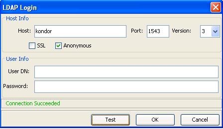

I'm trying to connect to SUn One Directory Server 5.2
I have no problems in connecting using etldap as Anonymous (
see 01_connect

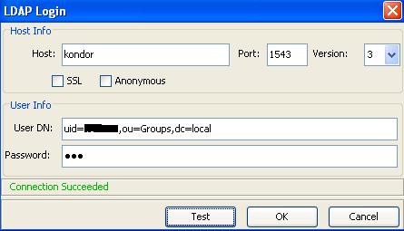

), or using User Info
(see 02_connect
After it I export user to TM1 server using etldap
and here I've stuck
I've written many different lines in TM1s.cfg but result is the same
Login Failed: LDAPServerConnectionFailed when I'm trying to connect (using for example Tm1 Architect)

In your TM1 server configuration file tm1s.cfg you specified the TCP port 1543 as the TCP port used by your LDAP Server for LDAPS communication.
This must be wrong:
According to the two screenshots displayed by your first email 1543 is the TCP port used for LDAP communication as the checkbox "SSL" is not checked.
What TCP port is your LDAP Server using for LDAPS communication ?
That value you must set using the TM1 server configuration parameter "LDAPPort".
This must be wrong:
