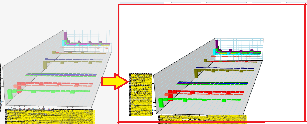

When I ask my TM1 to build 3D view it takes two steps. First - it shows picture in "fogged' mode; and Second - it takes a long time before showing it again (in normal, contrast mode).
Is it bug or our developing mistake somewhere?

1) there no feeders at all
2) I'm not sure it is possible to paste here client data.
Here is combination of screens I see when making 3D chart:
While making this chart my browser asks me for several times to stop script. I ckick decline to get result picture, but it compiles (as it seems to me) too long.
Re: Too long visualization time
I suggest you (or more likely whoever is specifying report and chart types on your project) to go read up on Tufte, Hichert and Few (a new version of Show Me the Numbers is out ...) and make an effort to present data in a more clear and meaningful way. BUT the god awful choice of junk chart isn't likely to be your problem but rather a poorly written calculation. If you are serious about getting help then you need to post the rule and not the chart.
Post by Gregor Koch »
Really don't mean to crush the chart and I agree with lotsa that it most likely is not the issue. But I can't help myself, this looks like a flight game from the 80s or a mixture between Super Saxxon and Root Beer Tapper.

Posts: 1458
Post by David Usherwood »
@ioscat, we don't need the data, just the rules.
But I'll stick my neck out and surmise that you aren't using skipcheck (and feeders) so you aren't taking advantage of TM1's sparsity handling. This will not work.

Hello to all. Thanks for your comments, spent a lot of time to translate all your "But I'll stick my neck out and surmise" and "But I can't help myself" and other. =)
Just asked my Boss, he didn't approved publication. But I can answer for question
David Usherwood wrote:But I'll stick my neck out and surmise that you aren't using skipcheck (and feeders) so you aren't taking advantage of TM1's sparsity handling
SkipCheck is used.
In addition I can say that calculations and recalculations goes fast enough (17 MB memory used). Maybe it is not properly fed, but is it possible to estimate feed rightness? An example by comparing two cell statictics numbers.
Maybe if I repeat this problem on sample model I'll post here rules. So on today topic should be temporaly stopped to not be trashed.
