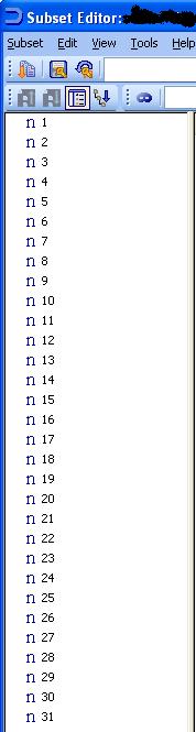

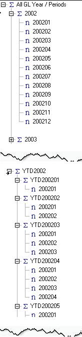

Re: Consolidate historical data
You need to create a cube which has Period dimensions (containing the Years and Months) and Day dimension.
See the sample screen shots for Period and Day dimensions.
This should give you a starting point....
- Day dimension
- Day_Dimension.JPG (19.44 KiB) Viewed 5252 times
- Period dimension
- Period.JPG (25.19 KiB) Viewed 5252 times
