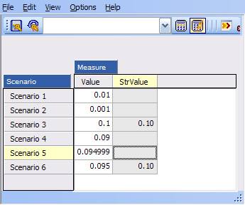

I feel like I'm going batty, but there seems to be an error with the STR function in TM1 9.4. Essentially, the STR function only returns a correct result if the value is 0.95 or greater. Otherwise, it returns empty strings.
I've attached an image displaying the problem. StrValue is calculated by the following rule:
FEEDSTRINGS;
SKIPCHECK;
['StrValue'] = S:
STR(['Value'], 15, 2);
FEEDERS;
['Value'] => ['StrValue'];
I also tested 9.1 SP3 with the same result. Has anyone else noticed this behaviour, or am I going crazy?

- Screenshot of the error
- TM1Err.png (9.81 KiB) Viewed 6247 times

Lazarus,
I tried this in 9.1.3 and it works fine.
['String']=S: STR(DB('Test',!Any,'Number'),15,2) ;
I think that your problem is the old chestnut that you cannot use [] notation on the right hand side of a String Rule. You must use DB() even if you are referring to the same cube.
Paul Simon
Paul Simon
