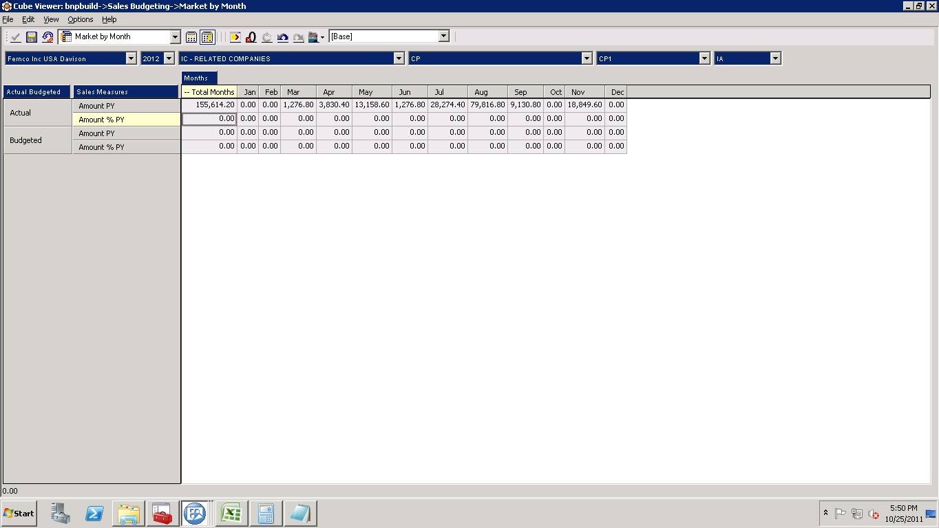

Hi Guys,
I have a Sales cube having the following dimensions
1.Sales Facility
2.Year
3.Month
4.Market Segment
5.Product line
6.Market
7.Item Sales Group
8.Scenario
9.Sales Measures(Amount,Amount %,Amount PY,Amount % PY,Pieces,Pieces %,Pieces PY,Avg Price PY,Avg Price)
I want the percentage of the Total Amount to be displayed as the user navigates through the entire cube.
['Amount %','Actual']=['Amount','Actual']\['Total Months','Total Market Segment','Total Product Line','Total Market','Total Item Sales Group','Actual','Amount']*100;
I am using this formulae for calculating the Amount % but it works only when I have all these dimension selected at the consolidation level, if i select leaf level elements it is not showing the % as expected.
For Eg;
I have attached a file.
In this ideally when the user looks at the cube the % should be based on the elements selected and the value for the total months.
But because of the formula it uses the value of
'Total Market',
How can i make this work, I request some one to please help me on this.
Thanks.

- market by months.jpg (138.98 KiB) Viewed 15282 times

If this is the case why not just divide by the figure for total months, leaving the elements on the other hierarchical dimensions unspecified?karan2345 wrote: In this ideally when the user looks at the cube the % should be based on the elements selected and the value for the total months.
Thanks.
['Amount %','Actual']=['Amount']\['Total Months','Amount']*100;- qml

To me it's not really clear what you want to achieve and so I don't know if your rule is doing that. Having said that - the rule itself looks like it should calculate something.
Are you sure there are no results showing up on leaves? Maybe they are so small that with the precision you're using they are rounded down to 0.00? You should right click on any of the cells where you expect a value and use the "Trace Calculation..." tool (as always when debugging rules).

Hi qml,qml wrote:To me it's not really clear what you want to achieve and so I don't know if your rule is doing that. Having said that - the rule itself looks like it should calculate something.
Thanks for the help.
Yes it calculates the value but that is not what i expect it to do.
As you can see in my calculation I am taking total of all dimension and using that value to get the %, this would be good when the user is viewing the data at that level,
but as soon as the user selects a different view the % is not coming as expected.
Is there a way to find out what is the level of cell selected by the user and do calculation based on that?
For instance the user might select Months in the column as given in the attached file.
So for this I will use 'Total Months' as my basis to calculate %.
if the user views it by Market Segment then
I will use 'Total market segment' as the basis to calculate %.
and so on for all the other dimensions.
Can this be done by using some logic in tm1?

Not the way you want it, it can't be fully contextual like that. However you can create separate measures to capture percentages with respect to total year, total market etc.karan2345 wrote:Can this be done by using some logic in tm1?

qml wrote: Not the way you want it, it can't be fully contextual like that. However you can create separate measures to capture percentages with respect to total year, total market etc.
