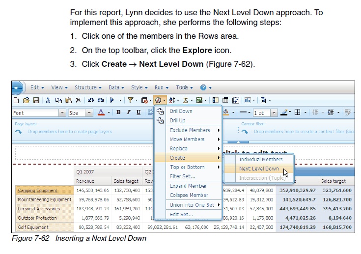

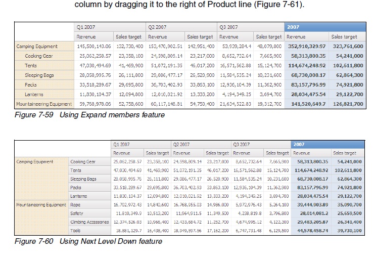

I thought about this to put all the the level into one attribute but user feels that there should be a proper way around to do it. The user uses powerplay before therefore already had an expectation that the new system that is put in should have identical feature as well. I was reading through the IBM Cognos BI V10.1 handbook. The outcome seems to be something i am looking for. It mention something about "Next Level Down" feature. I followed the same procedure mention but somehow the "Next Level Down" is grayed out and it doesn't allow me to click on it. I wonder if this feature is supported using TM1 data.rkaif wrote:Winson,

For this report, Lynn decides to use the Next Level Down approach. To
implement this approach, she performs the following steps:
1. Click one of the members in the Rows area.
2. On the top toolbar, click the Explore icon.
3. Click Create Next Level Down (Figure 7-62).
