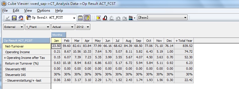

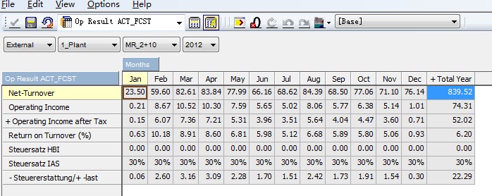

Thanks for so more reponses for me. sorry for offered less information, now I try to upload two pictures, wish that can help you know my issue,
in fact all data of pic MR2+10 come from by rules
[{'MR_1+11','MR_2+10', 'MR_3+9','MR_4+8','MR_5+7','MR_6+6','MR_7+5','MR_8+4','MR_9+3','MR_10+2','MR_11+1','MR_12+0'},'Jan']=N:['Actual','Jan'];
[{'MR_2+10', 'MR_3+9','MR_4+8','MR_5+7','MR_6+6','MR_7+5','MR_8+4','MR_9+3','MR_10+2','MR_11+1','MR_12+0'},'Feb']=N:['Actual','Feb'];
[{'MR_3+9','MR_4+8','MR_5+7','MR_6+6','MR_7+5','MR_8+4','MR_9+3','MR_10+2','MR_11+1','MR_12+0'},'Mar']=N:['Actual','Mar'];
[{'MR_4+8','MR_5+7','MR_6+6','MR_7+5','MR_8+4','MR_9+3','MR_10+2','MR_11+1','MR_12+0'},'Apr']=N:['Actual','Apr'];
[{'MR_5+7','MR_6+6','MR_7+5','MR_8+4','MR_9+3','MR_10+2','MR_11+1','MR_12+0'},'May']=N:['Actual','May'];
[{'MR_6+6','MR_7+5','MR_8+4','MR_9+3','MR_10+2','MR_11+1','MR_12+0'},'Jun']=N:['Actual','Jun'];
[{'MR_7+5','MR_8+4','MR_9+3','MR_10+2','MR_11+1','MR_12+0'},'Jul']=N:['Actual','Jul'];
[{'MR_8+4','MR_9+3','MR_10+2','MR_11+1','MR_12+0'},'Aug']=N:['Actual','Aug'];
[{'MR_9+3','MR_10+2','MR_11+1','MR_12+0'},'Sep']=N:['Actual','Sep'];
[{'MR_10+2','MR_11+1','MR_12+0'},'Oct']=N:['Actual','Oct'];
[{'MR_11+1','MR_12+0'},'Nov']=N:['Actual','Nov'];
['MR_12+0','Dec']=N:['Actual','Dec'];
however you can see some data have change at MR2+10 pic when I change the dimension to MR2+10.

I take it you didn't build this cube and you're trying to work out what it does? It looks to me like it's a rolling forecast cube. It's a bit hard to tell with those element names.
Actuals are actuals. They will be loaded by some process or other from your general ledger or other source system.
I think MR_2+10 is the rolling forecast as at February. So the year to date months (i.e. January and February) are retrieved from the actuals. However all subsequent months are left open for the forecast to be entered.
So by choosing "Actual" or "MR_2+10" you are choosing different scenarios. The first is actual data. The second is the forecast as at close of February.
Even if I'm not quite right about the intention of the cube, that should at least explain why your data moves when you change the scenario. By the way, I would expect the values in a cube to always move when I change one element from another. E.g. changing the year from 2011 to 2012 will change the numbers. Changing "External" to "Internal" should change the numbers.

thanks for your so nice interpret, yeap, below two snapshts are from cube A that all data come from cube B by rules, B also have same dimension with Actual and MR2+10…… members, for cube B, all actual data come from bussiness data by input by me( for testing ), then I change the member to MR2+10 and copy Mar~Dec data then paste to MR2+10's Mar to Dec. thus the data for Actual and MR2+10 are same for cube B, in fact the below Actual snapshot have the same value with cube B, however that changed in MR2+10 ...

What I think you're saying is that you manually input the 'Actuals' into cube B and then manually copy the figures in 'Actuals' for 'Mar' to 'Dec' into MR_2+10 in cube B. You say that the data in cube A is pulled from cube B via a rule. Is that correct?
However the only rules you've posted are internal to cube A - that is don't show how the data is pulled from cube B. Plus, as Martin has pointed out, the rules you've shown us only populate 'Jan' and 'Feb' for the element 'MR_2+10' and your screenshot shows that the numbers are the same for these months.
So if your problem is that the values for 'Mar' to 'Dec' are not the same for 'Actuals' and 'MR_2+10' you need to look at how these values are being populated. Learning how to use the rules tracer can be pretty useful in these situations:
http://publib.boulder.ibm.com/infocente ... F0007.html
I'm guessing though, that Martin is right and cube A is doing some sort of rolling forecast. In which case you wouldn't necessarily expect 'Actuals' and 'MR_2+10' to be the same.
If you're stuck, perhaps you could post more of the rules in cube A?
