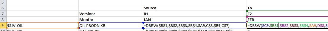

I am using Perspective to populate data using DBRW and DBSW to copy data. The purpose of this is to allow user to copy data from column 'Source' into column 'To'.
The problem is how to avoid the data from automatically being updated the cube view until user click on button or F9 key.
I have tried to set the calculation to be Manual. However, if I select Manual then the cube will not get updated even after i hit F9 key. Did i miss out anything?
Please help.
Thank you.
