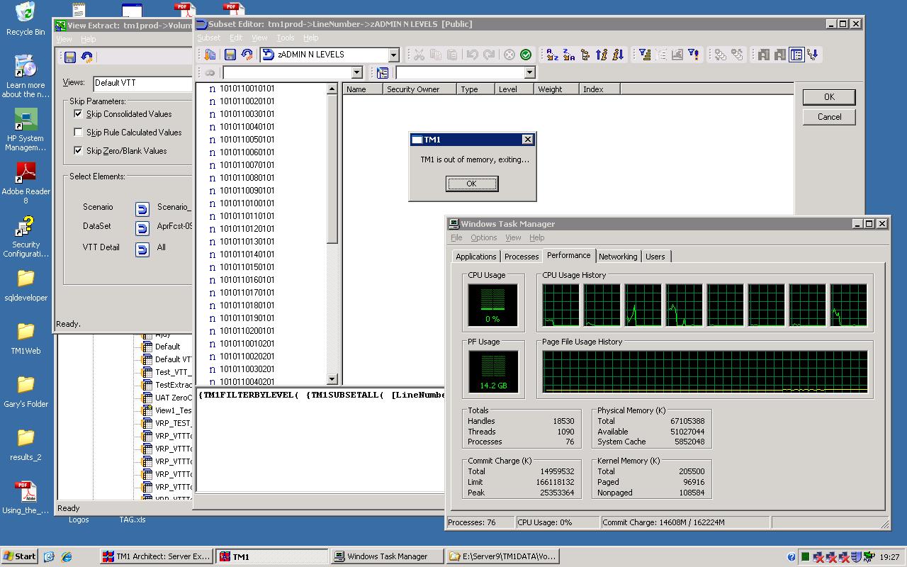

Wondering if any of you have had a similar experience. As you can see from the screenshot I have encountered a "TM1 is out of memory, exiting" message and as you can see from the task manager there is approx 67GB RAM on the server and about 51GB RAM available with the rest committed.
My tm1s.cfg file has the "MaximumViewSize=60000" so I think I have enough memory to cater for most views.
The error message occurred when amending one of my views via TI, which is based on a cube with is quite small in memory approx 380KB but does contain one dimension with approx 20million elements representing composite keys...which is telling me uses 4.8GB of memory.
I am wondering why, with so much memory available, not to mention approx 97GB of page file memory, why TM1 has run out.
Any words of wisdon would be appreciated

The screenshot is actually from the server.
I have a copy of perspectives which is installed on the server itself.
The dimension has 20million elements
Ajay

Sorry, I mistaken wrote "amend via TI", I am actually using the "Export as ASCII data" to amend a very basic view of the cube.
I am wondering whether I should amend the view using a bit of TI instead, but everything still points to why is the system out of memory when so much is available ?

The limit you are exceeding is on the server and seems to be the maximum size of a subset that can be edited. You possibly built this via TI and this is the first time you are editing it and 20m elements is mhoosive.
You could build a smaller subset of the most likely values and point the user to that as a starting point or your design may have to change in that you split your composite key into multiple dimensions.

I would try and replace the dynamic subset you seem to be using with a static one. Maybe the subset recalculation is what takes up all this memory?
