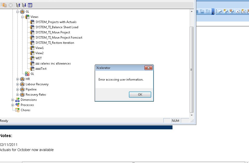

If the user opens server explorer then drills downs to views/cubes etc.
If the user then logs out of CE using the excel front end which my VBA calls
Run ("N_DISCONNECT")
The get a"error accessing user information" pop up for each level of the server explorer the user is drilled into.
See below:
Anyone know of a workaround for this?
I tried
M_CLEAR
as per http://www.tm1forum.com/viewtopic.php?f=3&t=1150
error- accessing user info- on logout.jpg (60.89 KiB) Viewed 3020 times

Guys I have found that the issue occurs when users have cubes or views open in server explorer and try to log off via the front end running
Unfortunately my users want the sheet to close them out of server exploer
I tried
' Opens server exlorer then closes (just incase in was open for fix CE-44)
Application.Run "TM1StartOrionWithAutomation"
CreateObject("WScript.Shell").SendKeys "%{F4}", True
But this doesn't work in citrix
I was going to use GetObject to find out if Sever explorer is open, anyone know the application name for server explorer?
