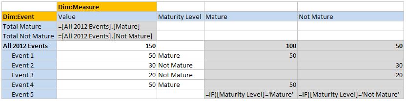

Kaveenga
Posts: 59
Joined: Mon Jun 02, 2008 8:49 pm
OLAP Product: TM1 Palo
Version: TM1 9.x Palo 3.2
Excel Version: 2003 2007 2010
Re: SUMIF function in Rules?
Post by Kaveenga »
An approach could be to have extra measures in the cube for each maturity level, which you can rule across the value depending on the maturity type selected by the user.
Maturity Levels.JPG (41.68 KiB) Viewed 8822 times
DevGreg
Posts: 14
Joined: Tue Sep 09, 2008 4:12 pm
Post by DevGreg »
Nice workaround, thank you guys!
I may encounter some issues as there are 3 different cost data entry (for 3 currencies, modelized with 3 measures), but this was just the help I needed to make me think "out of the box".
