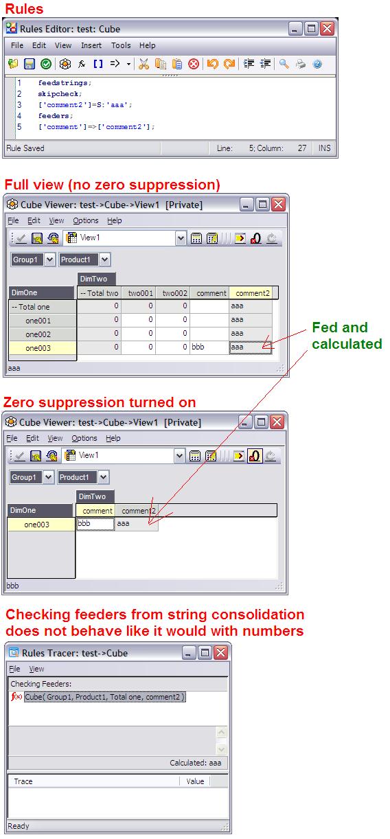

John, is it possible you tested it on 9.0 version (that is shown under your name) only?John Hammond wrote: I built the example and you are correct that only one child needs to be fed, but that child also needs to be calculated in the Target cube. This applies to both string and numeric consolidations.
I did a retest (as in one of the previous posts in this thread I claimed I checked it on two versions and the result was, feeding just one child is not enough), and my retest still does not make consolidated string visible after zero suppression. See picture, tested on 9.5.1 HF17.
At the bottom of the picture I also decided to check how 'Check feeders...' will work in this case (on my version of course
- FeedingStringLeaf.JPG (108.41 KiB) Viewed 13620 times

I copied your example in 9.0 and got the behaviour you describe. Previously my feeders had been external feeders but once I tested that again I found my mistake. ( I have corrected my previous post to avoid confusion for future readers)
When you are testing zero suppress you have to be very careful to limit the view to the consolidated elements you are testing only. If one cell gets filled in the grid TM1 will check along the rest of the line in the non zero suppressed way to produce the right answers.
I then tested feeding directly to the consolidated level. This worked. However as mce pointed out this works in the same way as numeric feeders in that feeding a consolidation is short hand notation for feeding all the children. Hence you have the potential to overfeed.
I thought then that the rule must be: "All N level children of a string consolidation must be fed for that string consolidation to be fed" so I fed each N level child explicitly without using the shorthand notation. This did not result in a feed to the string consolidation!
So my conclusion would be along your lines "A string consolidation must be explicitly fed by reference to that consolidation for that string consolidation to be fed at the risk of overfeeding. String consolidations cannot be fed by feeding their N level children. Even feeding ALL N level children explicitly will not result in the string consolidation being fed, despite it being shown as the equivalent feeder in the rules tracer when you trace feeders."
I would be interested to know if your conclusions are the same.

To be honest, I wouldn't even think of checking this, as I see no significant difference between one, some of or all children in this case.John Hammond wrote:I thought then that the rule must be: "All N level children of a string consolidation must be fed for that string consolidation to be fed" so I fed each N level child explicitly without using the shorthand notation. This did not result in a feed to the string consolidation!
But, as I always try, I checked the all children example, consolidation string was still not there after zero suppression and yes, my conclusions are the sameJohn Hammond wrote:I would be interested to know if your conclusions are the same.
