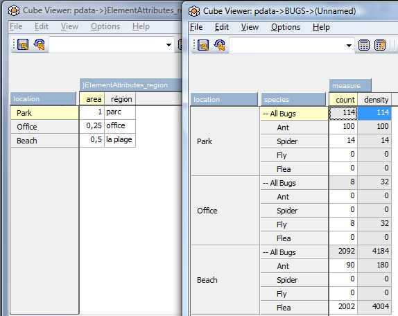

As a more general question, if I were laying out tables in a schema, how would this intent be captured then? As a attribute of the Location table, which would be a dimension table?
correct. An attribute in your location table. Your Attribute "cube" in Palo is representing this table - it is a two dimensional "cube".
In your fact table Bug_Count you join the dimension tables over id s and one measure is 'count'. All measures you collect in one dimension in Palo.
And then I would have my business intelligence engine just understand, through some configuration, that the "measure" of density was to be calculated as the sum of Bug_Count / the sum of the Area attribute from Location_id?
In Palo you would add an element in your measure dimension 'density' and create a rule for the cube. This measure is then calculated on the fly, similar to: ( the following is TM1 code, you need to adjust for Palo).
['density'] = N: ['count'] / DB('}ElementAttributes_location',!location,'area');
