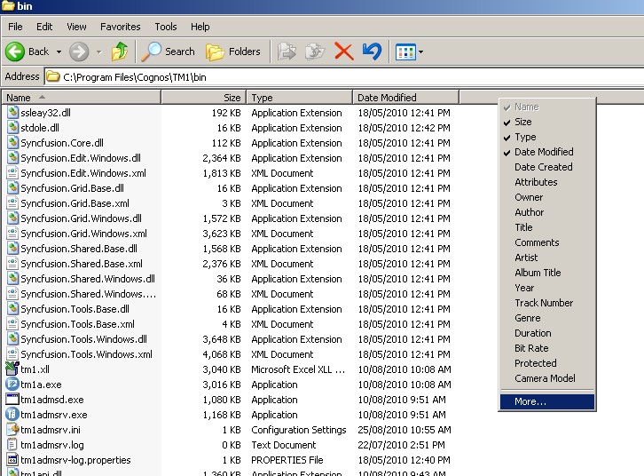

(c) Right click near the top of the list (in the heading tiles) to bring up the field chooser as shown:

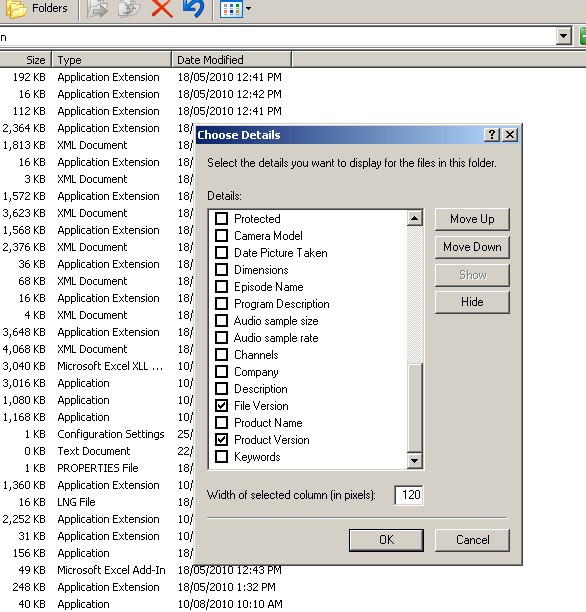

Go to the More... option and scroll down until you find File Version and Product Version, then check those boxes. Note: File Version will only be found in XP / Server 2003 operating systems or later. You won't find it if you're still running Server 2000.

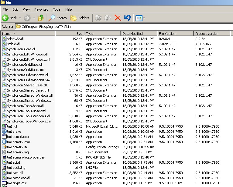

You should now be able to easily see the version numbers of all relevant files:

If conditions are as Alan mentioned, you can also find the version by simply right-clicking on the the .dll/.exe file of interest, choose Properties > Version > then select Product version. This may be easier, especially if you don't want to have the extra columns showing in your Explorer view.
Re: Quickly Determining Your Current TM1 Version
Kim wrote:If conditions are as Alan mentioned, you can also find the version by simply right-clicking on the the .dll/.exe file of interest, choose Properties > Version > then select Product version. This may be easier, especially if you don't want to have the extra columns showing in your Explorer view.
If you're looking for one file, possibly. I believe that the suggester's intent was to enable an overview of the versions of all files to be visible (particularly when looking for incompatibilities), so that you don't have to have the IBM support person sitting on the line as you check and read each one out manually.
