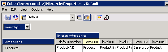

I am trying to open a TM1-cube in Report Studio after publishing the cube in Framework Manager. When I open the cube I can not see the levels, although I have defined them in }HierarchyProperties and set up a TI-process where I execute the command: RefreshMDXHierarchy('Dimennsion'). Any idea what I may forgot?
Is there something I could have done wrong in }HierarchyProperties? Attached please see my definitions.

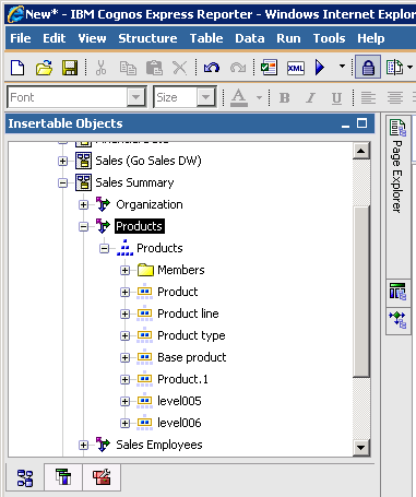

Been having the same issue in Express 9.0
DMR example of what we are expecting (members & levels): TM1 demo data source (members only): Tried editing }HierarchyProperties cube
Used TI to RefreshMDXHierarchy('Products');
Saved & restarted server
Re-published FM package
Same result - no levels.

Re: Reporting on a TM1 Cube with Report Studio
hang on a mo - it does work!
I don't think you need to re-start the server either. Just be wary of the C8 refresh lag. I remember there is a parameter somewhere to change that.
- Levels_ex_TM1.png (17.38 KiB) Viewed 16603 times
