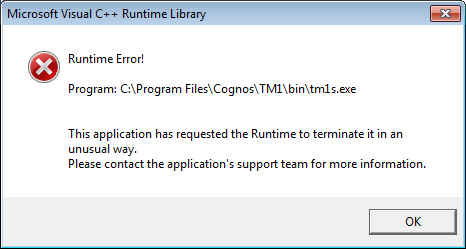

Please refer to attached image. When I run a TI that copies forecast data from one version to another, the TM1 server crashes. The message is "Runtime Error! Program C:\Program Files\Cognos\TM1\bin\tm1s.exe
This application has requested the Runtime to terminate it in an unusual way. Please contact the application's support team for more information."
FYI, the TI first creates a new Forecast Week version element and then copies the data from a source version into the new element. Also, the errors above happen for both original 9.5.1 and after I had applied Hotfix 11.

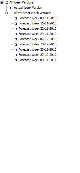

FYI, the changed rule below DID NOT help the TI issue, the server still crashes. Only deleting the rule helps. I have also attached an image of the Week Version dimension for your reference. Thanks!

- Week Version.jpg (15 KiB) Viewed 5223 times

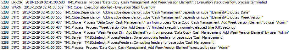

I have attached the error log after running the TI. I have created a TI to:
1) in the Prolog, first load a dummy rule file using RuleLoadFromFile function. The text file only contains a "#".
2) in the Epilog, check that the new Week Version element does not exist in the dimension using DIMIX = 0. If DIMIX = 0, then create the new element and attributes by executing a process "Wee Version Dim_Add Element".
3) Next, execute another process "Data Copy_Cash Management".
4) Reload the original Rule Worksheet.
In seems from the error log, that the error occurs at Step 3 in the Epilog when the Data Copy process is running. There is a stack overflow. Also, I noted that the RuleLoadFromFile in Step 1 did not complete even when the TI proceeds to Epilog. This is evidenced from the Rule Editor which still shows the original codes.
