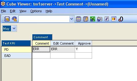

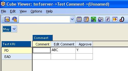

I have a req where in the below cube, user has to enter comment in 'edit comment' field. When ever higher official likes the comment, he has to enter 'Y' in Approve field so that comment from edit comment will be copied to Comment filed.
I used the foll rule
['Comment']=S:(IF(DB('Test Comment',!Test Date,!Test KRI,'Approve')@='Y', DB('Test Comment',!Test Date,!Test KRI,'Edit Comment'), STET));
If user writes something in edit comment, as Approve has already Y in it, it directly goes to Comment field.
I want to gray out(non editable) the EditComment field when ever Y is typed in Approve field.
I tried to assign some rule so that it grays out if Approve is Y, But am getting error.

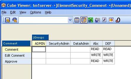

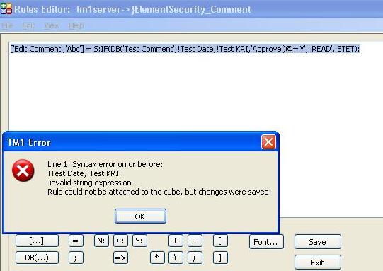

I tried to write a rule in Control cube But am getting an error.
Rule:
['Edit Comment','Abc'] = S:IF(DB('Test Comment',!Test Date,!Test KRI,'Approve')@='Y', 'READ', STET);
Error:

Hi, I was sleeping here...
The problem is that the dimensions Test Date and Test KRI are unknown in the control cube.
So you can't use those as a variable.
Michel
