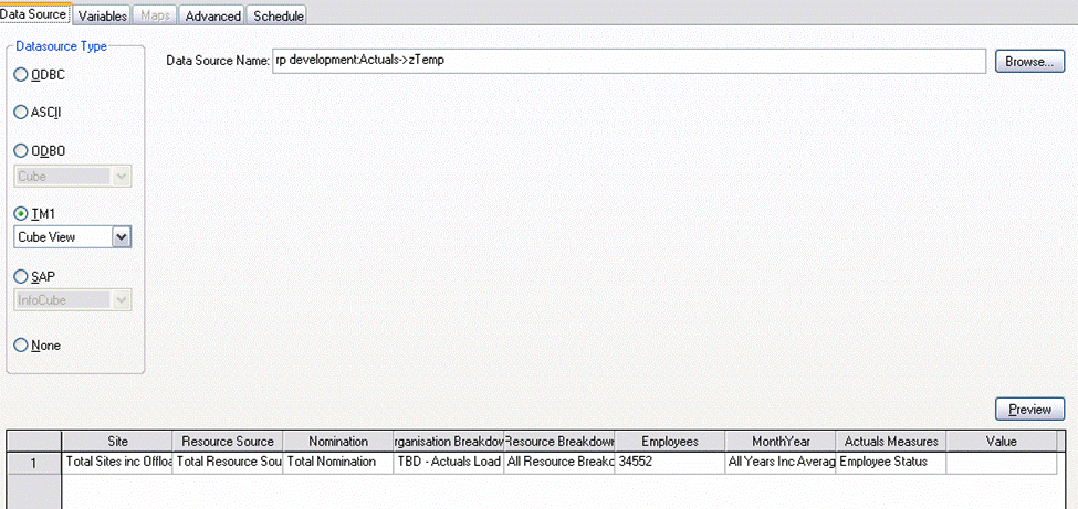

I can't figure out why this is happening, but it's killing my server and i want it to stop :roll:
Simple enough, a TI to copy from cube to cube. Dimension structures are identical as the idea is to archive the data in to a new cube, which will later allow us to move it offline. The TI, as i have done so before, creates subsets and views, works on them then deletes them when it's done. The problem is with the view creation, its corrupting and i don't know why.

The TI has the "zTemp" cube view as it's datasource. If i asciioutput the 8 dim names at the end of this, they are all correct and in the right order. Problem is TI swaps dim 1 and dim 4 when it views them as a datasource. If i write a TI to just look at the cube view, the order is incorrect in the preview and this results in the TI throwing a hissy fit and never completing, eventually consuming all the RAM and the service crashes.
Has anyone got an idea why the hell TI would swap these 2 dims around? Even when you check the view via "Export as ascii" in server explorer, it all looks right...

Neither forcing a re-read or creating it from scratch work. When you look at the .VUE file on the server you can see the dims are in the wrong order, it's simply creating a view incorrectly when using the ViewCreate statement. I've logged it with Cognos and have had a call about it already, it is behaviour known to them and it was believed to be fixed, we're just awaiting some details back from engineering as to which release that happened to be in.
I'm already using this code on the production server and it works fine, albeit those cubes are only 2d in size. I'm using 9.0 SP3 but the prod is using build 173 and dev is on 182. It does exactly the same for this cube in prod so if it wasn't fixed until 9.1 i'm stuffed as we've no hope of changing to another point release. According to Insight there are 2 other builds after 182, so i'm hoping one of them included this fix.

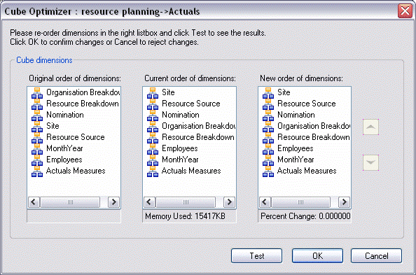

Re: Turbo Irritator at it again
Has the natural cube dimension order been reordered? This can cause problems between front and back end views fo the same thing?

«insert expletive here»
Why didn't i think of that before? You are spot on Steve, the order the TI is building the view is the reordered cube order, not it's physical cube order. It's plain as day in the attached screenshot.
Cube Reorder Screen
Cube Reorder Screen
That's the bug, now all i have to do is hope its fixed somewhere in 9.0. I'll try the TI with the dims affected in the other order but i'm not convinced it'll work, as i'm guessing the reason it was sapping all the RAM was trying to work out the physical/virtual orders of the cube as it was loading the numbers.
