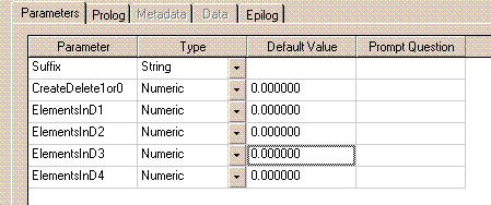

Screeenshot of parameter definitions, the TI has no data source
