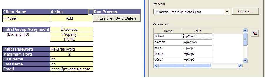

I was trying to do create a sheet that allow admin(in case Perspective or Architecture is not available specifically access it through TM1, or if someone given security is too lazy to go to the server and do multiple steps to create the user and the group that user belongs to) to add users. I was expecting if I added a TM1 Action Button, the parameter will pop up when you run it, however that is not the case. I was thinking of how create a worksheet or something to be able to allow TM1 to process to work. I'm trying this on TM1 9.5
Re: Process with Parameter
If a TI has parameters and you want to call it from an action button then the easiest way to do this is to enter the parameter values in worksheet cells and name range the cells, this makes them easier to refer to in the action button parameter arguments. Hopefully a picture is worth 1000 words.
