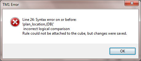

appleglaze28
- Posts: 269
- Excel Version: 2003
Re: Using String for rules
['Airfare']=N:IF (DB('Product_Gross_Margin',!Company,!Month,!Year,!Version,!Products,'Training Site')@=!TrainingSiteDimension,(DB('Travel_Assumptions',!TrainingSiteDimension,!Year,'PHP','Airfare Cost')*['Number of Trainee']),continue);
So I can only use precise statements in script like the one I did before.
#REGION AIRFARE COMPUTATION
['Airfare'] = N: IF (DB('plan_product_gross_margin_cost', !base_company, !base_month, !base_year, !base_product, !base_version, 'Training Site')@='Singapore',(DB('assumption_travel_cost', 'Indonesia', !base_month, !base_year, 'PHP','Airfare Cost')*['Numbe
['Airfare'] = N: IF (DB('plan_product_gross_margin_cost', !base_company, !base_month, !base_year, !base_product, !base_version, 'Training Site')@='Malaysia',(DB('assumption_travel_cost', 'Indonesia', !base_month, !base_year, 'PHP','Airfare Cost')*['Number
['Airfare'] = N: IF (DB('plan_product_gross_margin_cost', !base_company, !base_month, !base_year, !base_product, !base_version, 'Training Site')@='Thailand',(DB('assumption_travel_cost', 'Indonesia', !base_month, !base_year, 'PHP','Airfare Cost')*['Number
['Airfare'] = N: IF (DB('plan_product_gross_margin_cost', !base_company, !base_month, !base_year, !base_product, !base_version, 'Training Site')@='Indonesia',(DB('assumption_travel_cost', 'Indonesia', !base_month, !base_year, 'PHP','Airfare Cost')*['Numbe
['Airfare'] = N: IF (DB('plan_product_gross_margin_cost', !base_company, !base_month, !base_year, !base_product, !base_version, 'Training Site')@='USA',(DB('assumption_travel_cost', 'Indonesia', !base_month, !base_year, 'PHP','Airfare Cost')*['Number of T
rainee']),STET);
