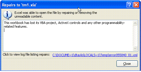

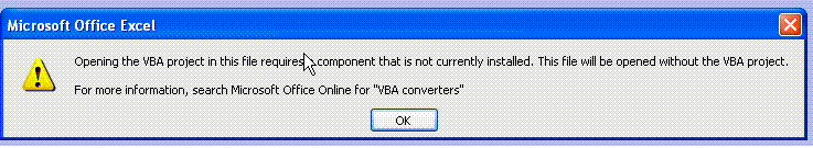

Hi Guys,
Not sure if anybody else has experienced this problem, but I am having an issue with the TM1.xla addin with Excel 2007 only. It was fine with Excel 2003, but now if I have the addin enabled, every time Excel loads, it gives me the two errors as shown below. However when I close these error windows, the Tm1 add-in seems to work anyway, but obviously it is really slow and annoying that every time I open Excel 2007, I have click through each of these windows.
There are 2 people in our office using Tm1 add-in in Excel 2007 and both are having the same issue. I have tried reinstalling Perspectives and also reinstalled Excel 2007, but I still get the same errors.
Can anybody help?
Damien

Damien,
TM1 9.0 is not supported on Excel 2007. The messages you are seeing are part of the reason why.
But as you have noticed, if you dismiss these warnings TM1 seems ok.
Not the best user experience though...
