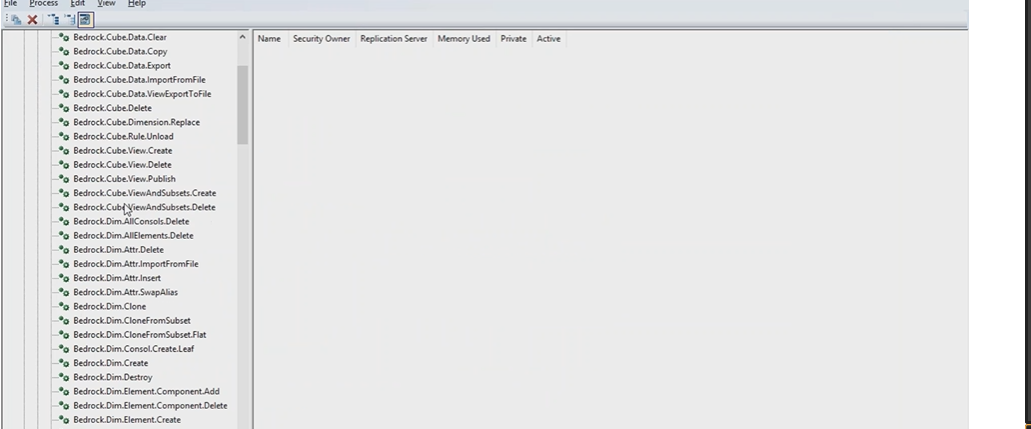

Hello, this is a dumb question again...the trainer in the pre-recorded online training session showed a bunch of processes he claimed to be taken from Bedrock (cubewise) website (see attached). He said everyone can access those...I went there but found nothing. I did register but still I didn't see any codes. Where can I find the codes on their site?

See this post.
Note that whatever you've taken a screenshot of is showing Bedrock 3 processes. Bedrock 4 ones are preceded by a brace.

You can download the newest Bedrock in Cubewise's Github
Bedrock3
https://github.com/cubewise-code/bedroc ... v3-archive
Bedrock4
https://github.com/cubewise-code/bedrock
Bedrock3
Bedrock4

You should pick Bedrock 4 if you install Bedrock fresh.
I came here in the new company and they using 2.0.4(or 2.0.3?) and its not easy to upgrade to the actual version cause they dont updated every version now many things obsolet.
