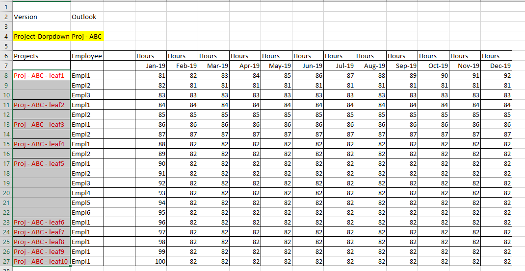

I am looking for an idea on how to filter in an Active form.
As shown in the picture, I want to allow users to pick the highest level of the project from a drop down and only the leaf level elements of the chosen project must be available.
Can someone please help me?
Paul.

Thanks Wim and Tomok.
I need some more help.
This is the code I see and where should I add?
I tried to add it towards the end, but it's erroring out. From the syntax, I placed it in the MDXStatement and in SubsetElements and failed in both attempts.
Code below is what I replaced with.
"E13" is the drop down list that has the Projects.
Syntax:
Paul.
=TM1RPTROW($B$9,"ABC:Projects","",'{AR}01'!$B$16:$B$17,"Number And Name",0)
{TM1FILTERBYLEVEL( {TM1DRILLDOWNMEMBER( {[YourDimension].["&E13&"]}, ALL, RECURSIVE )},0)}
TM1RptRow(ReportView, Dimension, Subset, SubsetElements, Alias, ExpandAbove,MDXStatement, Indentations, ConsolidationDrilling)
Paul.
