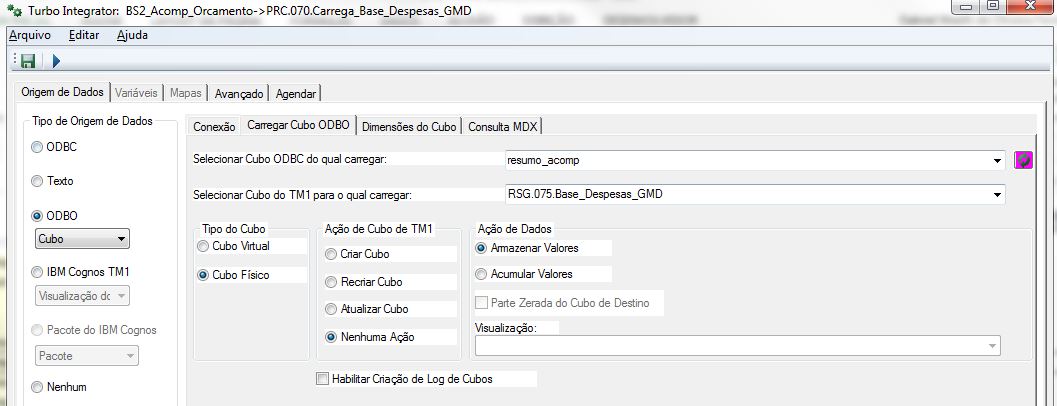

No, there is no source view as data source.
See some screeshots below. Where should I change to bring only the code and not the complete alias?
Here the cube on mapping:

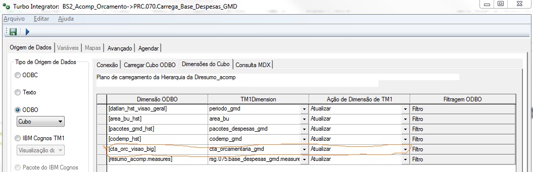

Here the dimension that I am facing the problem:

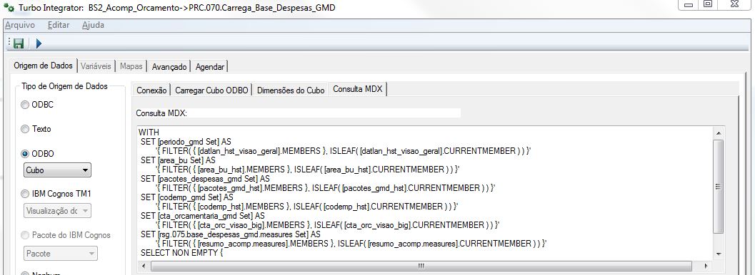

And here the mdx code that tm1 is generating on the process:

Hi Jim, I will post here the mdx generated.
WITH
SET [periodo_gmd Set] AS
'{ FILTER( { [datlan_hst_visao_geral].MEMBERS }, ISLEAF( [datlan_hst_visao_geral].CURRENTMEMBER ) ) }'
SET [area_bu Set] AS
'{ FILTER( { [area_bu_hst].MEMBERS }, ISLEAF( [area_bu_hst].CURRENTMEMBER ) ) }'
SET [pacotes_despesas_gmd Set] AS
'{ FILTER( { [pacotes_gmd_hst].MEMBERS }, ISLEAF( [pacotes_gmd_hst].CURRENTMEMBER ) ) }'
SET [codemp_gmd Set] AS
'{ FILTER( { [codemp_hst].MEMBERS }, ISLEAF( [codemp_hst].CURRENTMEMBER ) ) }'
SET [cta_orcamentaria_gmd Set] AS
'{ FILTER( { [cta_orc_visao_big].MEMBERS }, ISLEAF( [cta_orc_visao_big].CURRENTMEMBER ) ) }'
SET [rsg.075.base_despesas_gmd.measures Set] AS
'{ FILTER( { [resumo_acomp.measures].MEMBERS }, ISLEAF( [resumo_acomp.measures].CURRENTMEMBER ) ) }'
SELECT NON EMPTY {
[periodo_gmd Set] * [area_bu Set] * [pacotes_despesas_gmd Set] * [codemp_gmd Set] * [cta_orcamentaria_gmd Set] * [rsg.075.base_despesas_gmd.measures Set]
} ON COLUMNS FROM [resumo_acomp]
The problem is on dimension "cta_orc_visao_big" on bold. I am udptading the dimension "cta_orcamentaria_gmd" based on this dimension, but this code brings me the full code and I would like only the code, without the alias.
I have already tried to manipulate this mdx but is still the same.
CellPutN(nValue, 'RSG.075.Base_Despesas_GMD', datlan_hst_visao_geral,codemp_hst, cta_orc_visao_big, area_bu_hst, pacotes_gmd_hst,resumo_acomp.measures);
Thanks a lot.
JR.
