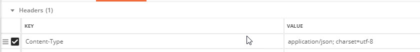

I know many TM1 error messages aren't that helpful, but in this case it is telling you exactly what you need to do. You need to add a Header in Postman for Content-Type and specify the value it's asking for:
This header is part of the request that makes its way to TM1 and lets it know how the contents of your request body are formatted. Yes, that's also the format it's expecting, but you need to explicitly say that in the header that you're sending.
Hope that helps!

Post by danz »
Spot on! Thanks very much Mike
