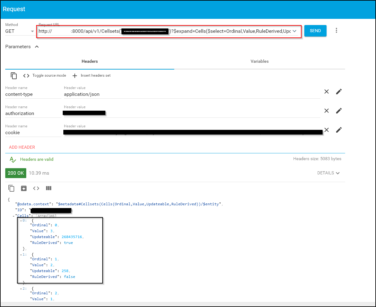

Do have another question, Is there any MDX statement to know whether the cube cells are readable or writable?
Can I use "Updateable"? but it returns "Updateable": 258 ??
?Cells($select=Ordinal, Value,RuleDerived,Updateable)
- Posts: 3234
Re: Tm1 - mdx query for cube cellset
What happens when you test it on both a cell that is updatable and one that isn’t ? Do you get a different result ?kavitha2002 wrote: ↑Thu Apr 04, 2019 8:11 am Can I use "Updateable"? but it returns "Updateable": 258 ??
Yes, for updateable its return different values for the one which can be updateable and non-updateable
- mdx-updateable.png (6.82 KiB) Viewed 11549 times

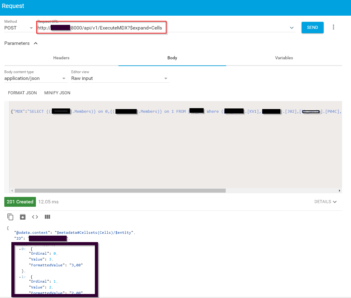

I dont want the entire cube cellset, based on the query I would like to filter the cellset.
Herewith I have attached the screenshots for both the query.
Do have another question, Is there a possibility of saying which cell is editable, non-editable and type of the cell(String, Number, Consolidated).
- REST-SecondRequest.png (54.66 KiB) Viewed 11412 times
- Rest-FirstRequest.png (35.83 KiB) Viewed 11412 times
