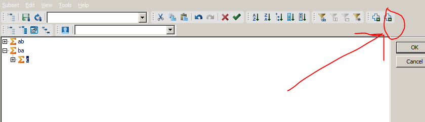

Looks like Ascendants only returns all parents in the first rollup?
Re: How to get top parent of an element ?
macsir wrote: Mon Feb 11, 2019 9:10 pm Looks like Ascendants only returns all parents in the first rollup?1.PNG2.PNG
Yes seems to be the case. I just checked with Ancestors function and seems to be the same restriction.

lotsaram wrote: Mon Feb 11, 2019 9:55 pm
Thanks for confirming. I am thinking if we can get same MDX function as what this "rollup" button does, it would be good. It can return all parents obviously.
