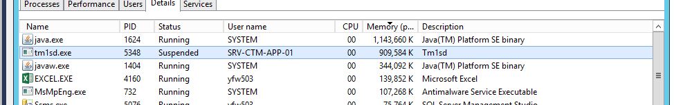

We have recently been getting intermittent PA server (11.0.5.79-0 on cmplst file) crashes when saving dimensions in Edit Dimension Structure.
Our dimension are rather small but when it happens, the status on the PA server goes into 'Suspended', the ram would drop then increase like it was trying to reload and then tm1sd.exe disappears.
There is nothing in the Tm1server file, the model is tiny and there is ample of Ram (server loads at 1GB. 5GB used. 58GB available)
TM1sd suspend crash.JPG (45.12 KiB) Viewed 16927 times
