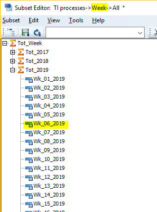

I was looking for an MDX way to find the next element in a dimension, if the base element is contained in a subset. Let me make illustrate this. I have a dimension of weeks:

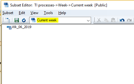

A subset called 'Current week' contains the... current week. Suppose we take Wk_06_2019:
Question: what MDX expression can we use to have the next week ? ==> Wk_07_2019

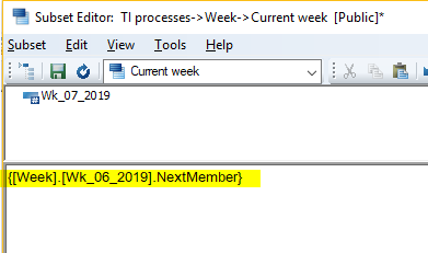

Because I know that NextMember works fine for hardcoded elements:
But that hardcoded thing in the middle should be the first (only) element of the subset 'Current week'. It's fine to have that subset name hardcoded in the MDX.

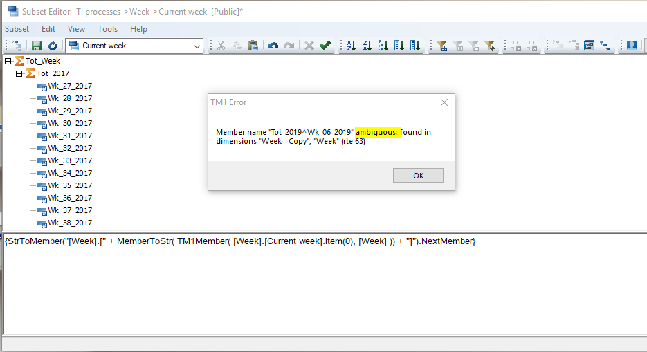

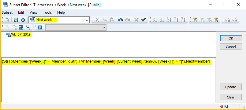

Now, I have been banging my head against the wall on this one and I seem to have a solution:
{StrToMember("[Week].[" + MemberToStr( TM1Member( [Week].[Current week].Item(0), [Week] )) + "]").NextMember}
doesn't look that pretty though. Moreover, it fails if the element name exists in ANY other dimension (or as an alias):
Without the other dimension in the model, it works fine:
3 notes:
- StrToMember and MemberToStr are not part of the list of MDX functions supported in TM1. This increases the need for a different (simpler) solution with supported functions.

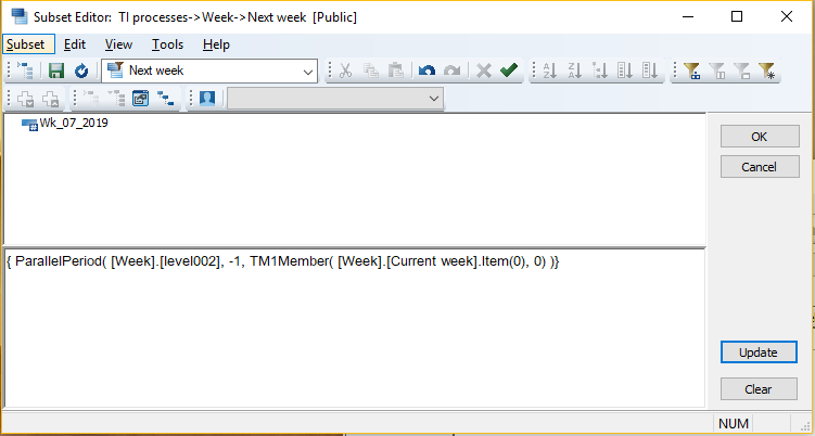

Got it ! I'm answering my own question ;-) but I learned new stuff today, and the 2 previous posts are interesting too.
I am now using the MDX function ParallelPeriod (which is supported).
{ ParallelPeriod( [Week].[level002], -1, TM1Member( [Week].[Current week].Item(0), 0) )}
The amibiguous character error of last post is solved here. You can have the same element names in several dimensions.

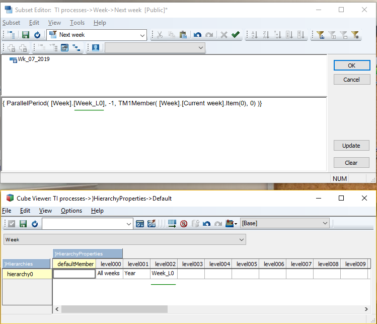

One last thing. If I want to use level names in Cognos BI, I would enter them in the }HierarchyProperties control cube.
Whenever you do this, you must run the TI command:
RefreshMDXHierarchy( '' );
# or for only 1 dimension:
RefreshMDXHierarchy( 'Weeks' );
or restart TM1.
As such, this breaks the MDX expression and the resulting subset is empty. You need to use the level name that you enter for level002, instead of level002. Then it works fine. You should use level002, however, if you did not specify a name for that level (within the given dimension/hierarchy)
