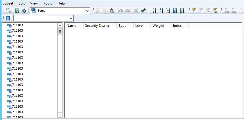

- Posts: 8
- Joined: Tue May 26, 2015 11:14 am
- OLAP Product: TM1, PAL
- Version: 9.5, 10.2.2, 2.0.1
- Excel Version: 2010 2013
Re: Subset Element Insert
Hi wim,
thanks for the code,
I have tried this as well before but got an error saying "Dimension element not found in dimension". I had to move the subsetElementInsert to the data tab coz of the error and it works only in the data tab. I also created a empty subset in the prolog tab but when I do this, the subset is created with the same element duplicated for each record processed (Attached screenshot). Once I move the subset create to the data tab, I am getting only one record and that too the last record of the file. I am unable to understand this behavior, I understand the subset creation should be in the prolog tab but why does it insert the same element for each record processed.
- Scenario1.JPG (41 KiB) Viewed 7457 times
- Posts: 3703
This is expected. You need to lean what happens on each tab of a TI process. In particular all metadata changes are done to a "shadow copy" of the dimension and the dimension is compiled only at the end of metadata. Therefore if an element is new to the dimension then you can't add it to a subset until the Data tab as new elements don't yet exist in the dimension until AFTER the metadata commit has happened. (The DimensionElementInsert & DimensionElementComponentAdd functions act on the shadow copy, the SubsetElementInsert acts on the original copy of the dimension.)
