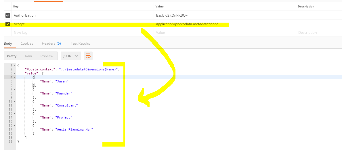

I will only use the TM1 REST API for a few things, one of them begin the wish to retrieve the dimension names based on a cube name.
So this URL:
http://aex199:8001/api/v1/Cubes('Aexis_ ... elect=Name
gives me in a browser:
{"@odata.context":"../$metadata#Dimensions(Name)","value":[{"@odata.etag":"W/\"26565daf22887161a551fe600fbbc005972d57aa\"","Name":"Jaren"},{"@odata.etag":"W/\"708364f3b711a6c2b7db532f9c2f2700c6864025\"","Name":"Maanden"},{"@odata.etag":"W/\"c5aebf69245b6e7f89ffde3eb2aa8d1f32e17971\"","Name":"Consultant"},{"@odata.etag":"W/\"a28acf2b428ba1c9ab0e4738db8a02ac7d6dd1a3\"","Name":"Project"},{"@odata.etag":"W/\"1201614e63a5fc83d18d084b577c9d9b03e2bdf8\"","Name":"Aexis_Planning_Msr"}]}
In the URL I filter on the "Name" and this gives me less output than if I do not filter on Name.
Still, why do we get those unique etag's or ID's ? Can we get rid of them or is the only viable solution to parse the JSON responsetext ?
With a number of filters this could also work but I would almost assume that the REST API should be able to only return the dimension names (in this case, it's a cube with 5 dimensions).
Many thanks for your insights.

Hi Wim:
Add this to your Accept header to tell TM1 not to return the OData metadata etags:
odata.metadata=none
Hope that helps cut down on some of the noise for you!
Best,
Mike
Mike Cowie
QueBIT Consulting, LLC
Posts: 3234
Re: TM1 REST API
Got it ! Many thanks !
