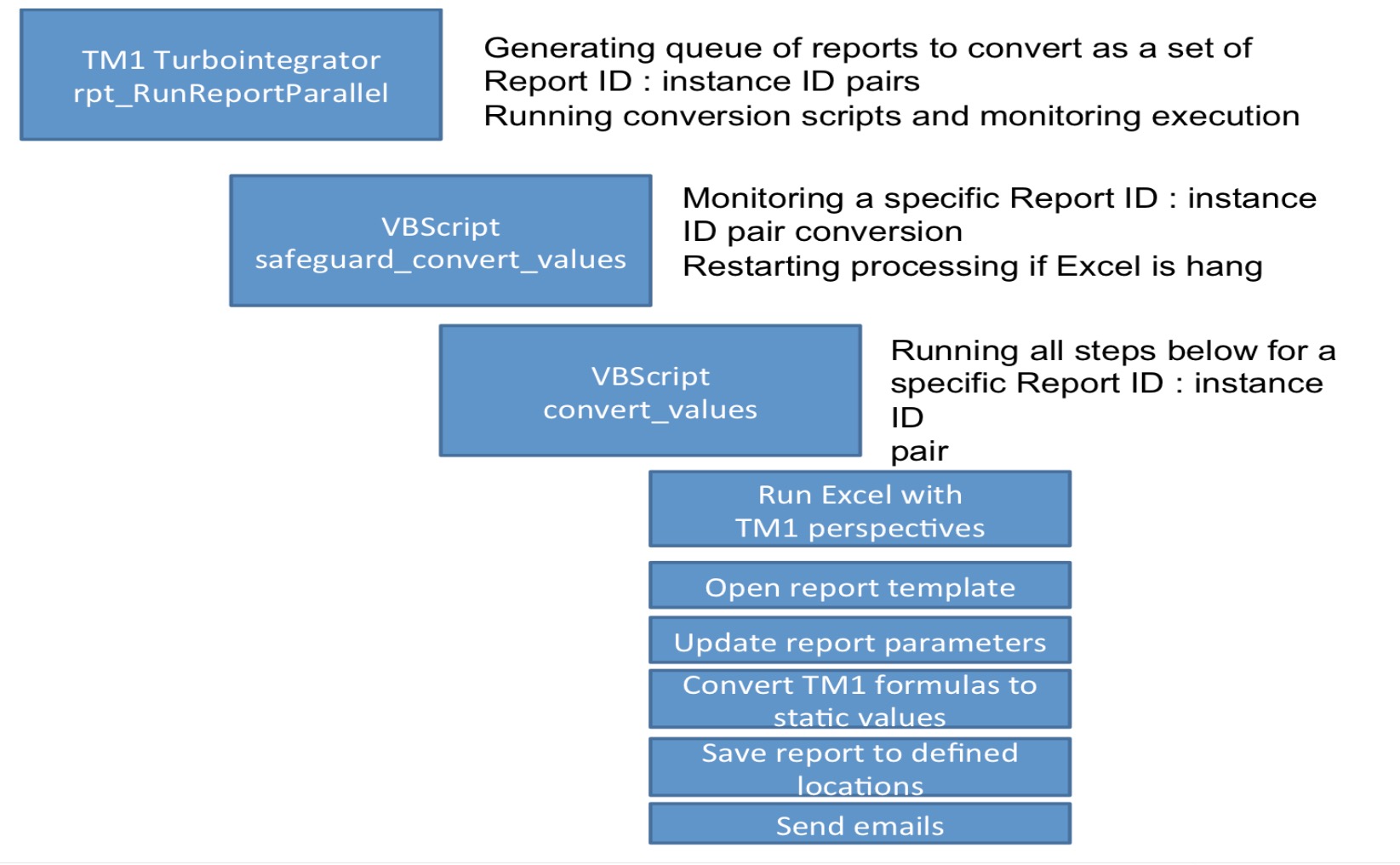

Just to add another data point: I have 4 projects where VBS is used to generate reports (connect to TM1, refresh the report, convert to values, the usual song and dance) that have been live for a at least a couple of years (5 years for the longest-running to date). The largest one generates ~500 reports daily. Most went through a couple of versions of Windows / TM1 / Excel without a lot of drama. So it's possible, although not the most interesting thing in the world, Excel is notoriously bad 'server-side' execution tool.
The overall logic is something like this:
Screen Shot 2020-07-01 at 10.11.15 am.jpg (204.72 KiB) Viewed 32057 times
Cheers,
Yuri
