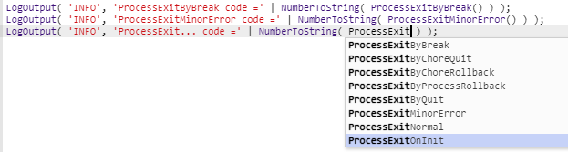

The error codes which that documentation is referring to are the error codes for tm1runti.exe which should not be confused with the exit code for the TurboIntegrator process itself ("process return codes").
If you want to validate the internal integer value of the process return codes this is quite easy to do by just wrapping each return code in NumberToString and outputting it.
e.g.
Then just look in the tm1server.log file
