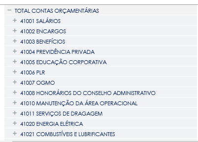

Hi Guys,
This is my first Topic here, so be patient...Lol
I built an Active Form Perspectives using MDX to control the lines that appear, showing a non-leaf group of elements, as the print below.
It's Showing correctly on Excel, but in TM1Web or Contributor, When someone expands(Drill Down) one line, the leaf level repeats all the elements below that consolidation twice or more.
The MDX that I'm using is :
{ DRILLDOWNMEMBER( {TM1FILTERBYPATTERN( {TM1SubsetBasis()},"TOTAL CONTAS ORÇAMENTÁRIAS")},{[GRL.D.Contas_Contabeis].[TOTAL CONTAS ORÇAMENTÁRIAS]})}
Sometimes It Repeats, sometimes it doesn’t, it's acting Weird.
Does anyone have any idea why?

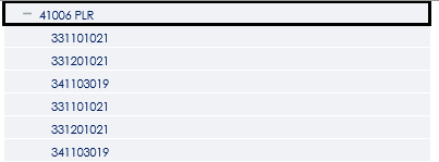

The first time I Try to Drilldown the second level of "TOTAL CONTAS ORÇAMENTÁRIAS" some lines (children elements) are shown twice (or more).
If i collapse the consolidated element, and then expand it again, the hierarchy structure becomes correct without repeated lines.

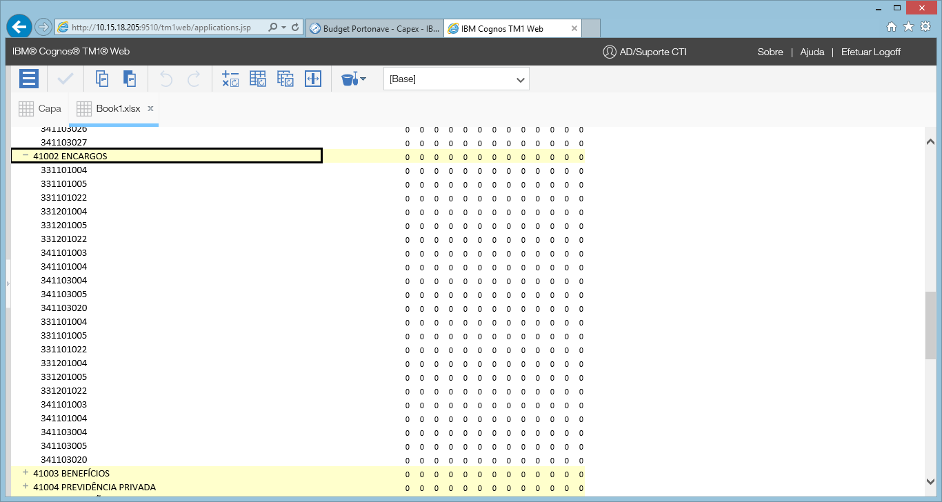

Even When I Clean The lines below de TM1RPTROW the Children elements of the expanded row is repeated as attached
Thanks again for the help!

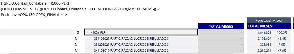

So difficult to know what to suggest without seeing your system. I doubt this will help but you could try:-
HIERARCHIZE(
{DRILLDOWNLEVEL( {[GRL.D.Contas_Contabeis].[TOTAL CONTAS ORÇAMENTÁRIAS]})}
If you replace the MDX with
{[GRL.D.Contas_Contabeis].[41006 PLR]}
what happens when you expand the element in the active form. Could you show us what happens when you use this MDX in the dimension browser and then expand the element there too?

Re: TM1RPTROW Repeat Problem
Hi AmbPin,
I Tried the 2 sintaxes, and get this response:
The first Attachment is the PLR test that You asked me to do.
The second one is using the Hierarchize sintax
But as You can see, the issue persists.
It's curious that sometimes, When I expand the hierarchy the first second it's ok, but the next, appears the same line again, repeating. It seems like some intermittent issue!
Thanks Anyway
Thanks Anyway
