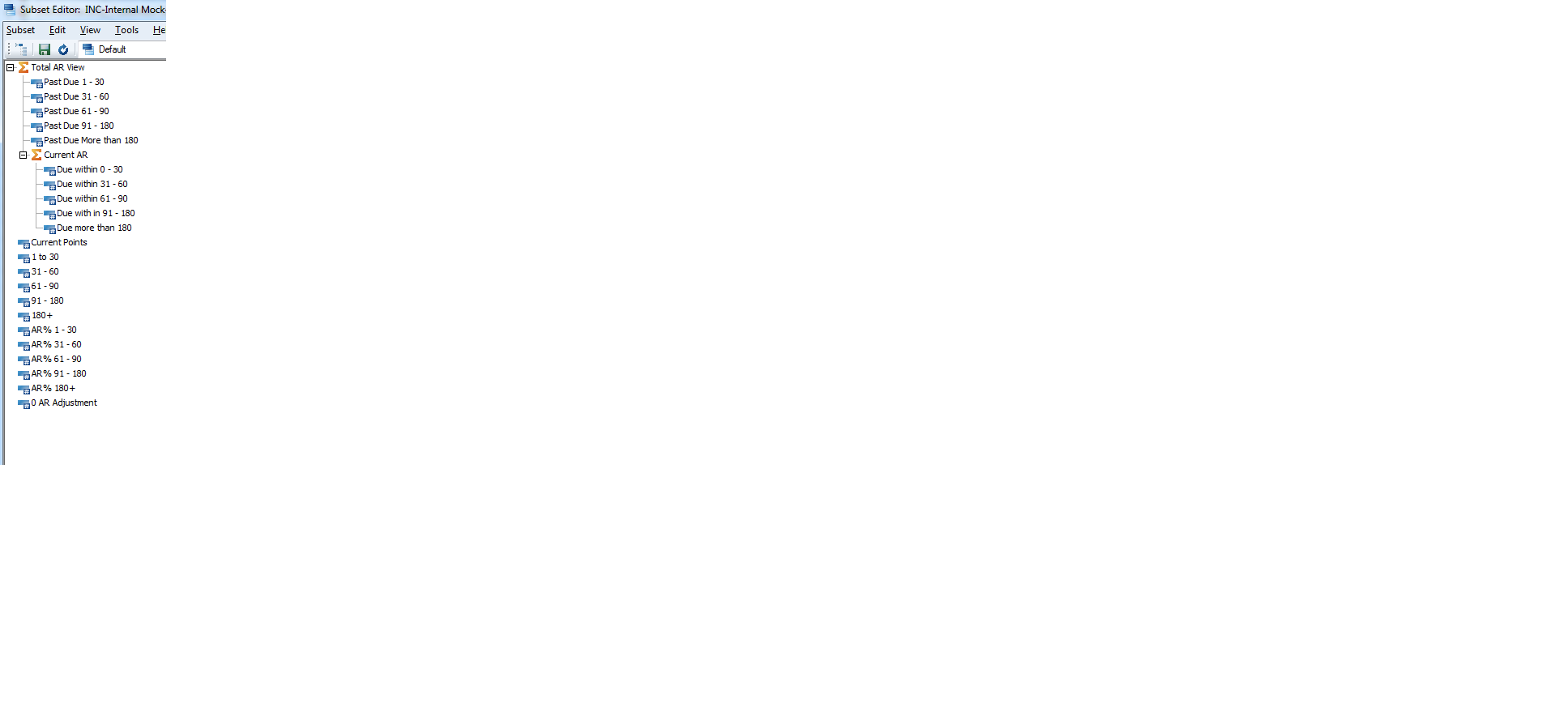

AR Measure looks like in the attachment .

- ARMeasureView.png (41.02 KiB) Viewed 5227 times
