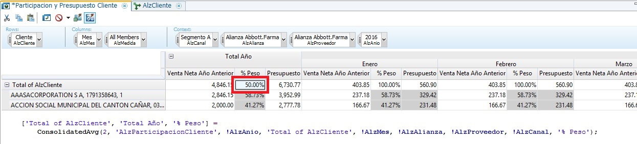

Anyways, I'm trying to use ConsolidatedAvg in a cube that has several dimensions (see the attachment). Among its dimensions, I have month and client. I am at the consolidated level of client and month (year), and in the rest of dimensions I am at leaf level. My rule is like this:
['Total of AlzCliente', 'Total Año', '% Peso'] =
ConsolidatedAvg(2, 'AlzParticipacionCliente', !AlzAnio, 'Total of AlzCliente', !AlzMes, !AlzAlianza, !AlzProveedor, !AlzCanal, '% Peso');
The cube is as follows:
I'm trying to get the average of a measure called %Peso with the value in each month but for some reason it calculates the average of the clients. I am getting a 50 instead of the 100 that I want to get.
Do you have any idea what I might be doing wrong? Thank you for your help.

ConsolidatedAvg gives you the average of all leaf cells below the one you have chosen with the coordinates.
It appears that you want the average of the sums across client. You should be able to get this simply by multiplying each result by the number of leaf clients feeding into it. You can get that number by having an attribute of the client dimension that you keep maintained, or by having a one dimensional cube, by client, with ones at leaf level and just reading off the consolidated values.

Hi ygrodrig6,How did you go by going through Duncan P suggestion? Thanks
