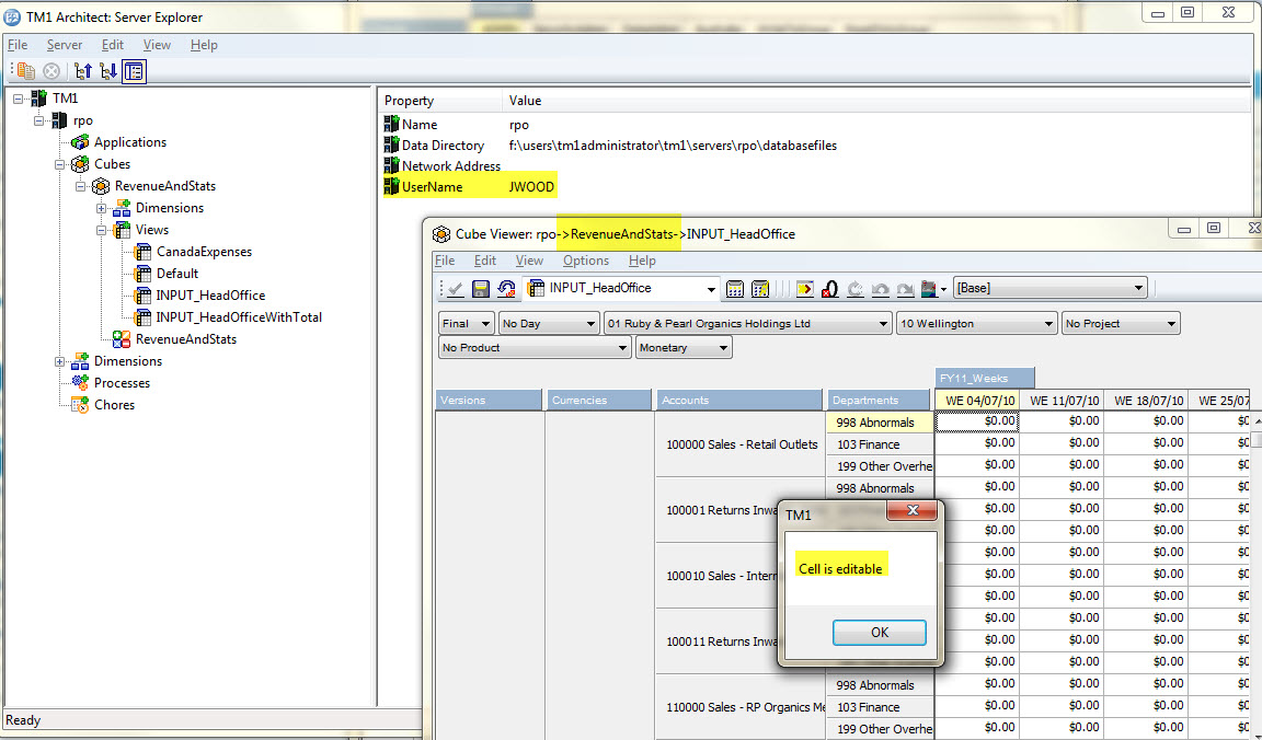

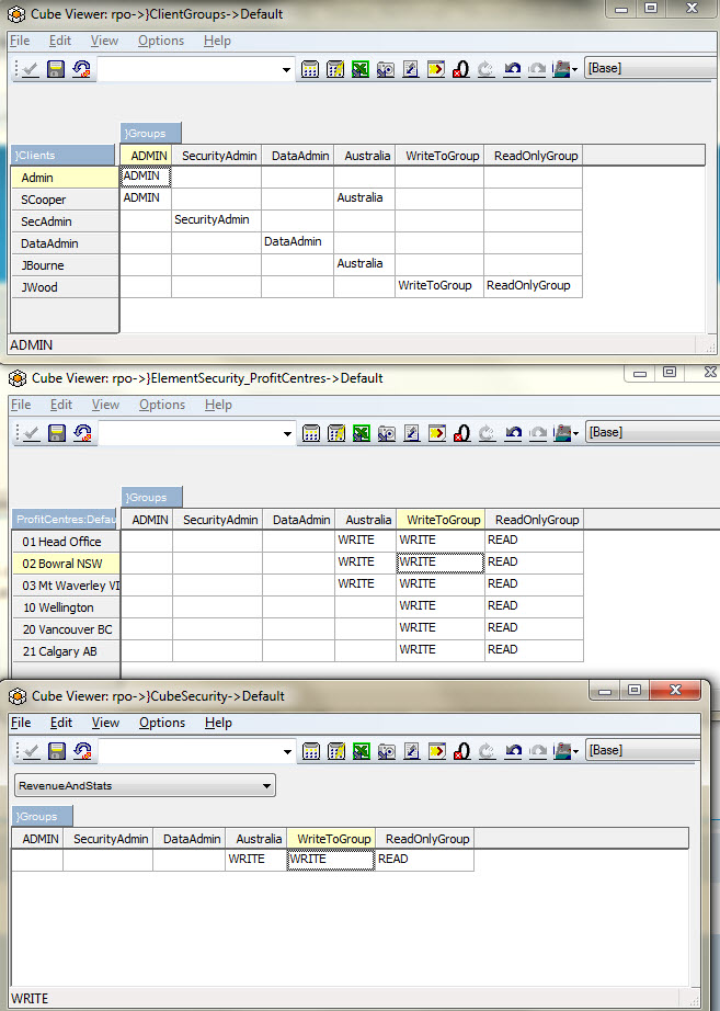

To paraphrase Al Borland, "I don't think so, Jim". Allow me to demonstrate.
I have created a read group and a write group. To the read group, I hath bestowed read permissions to cube and element, and no more. To the write group, I hath bestowed write permissions. And verily have I dumped a client named JWood into both groups (you'll need to scroll on this one to see all of the settings):
And I looked upon my work, and it was good. And verily did I log mineself into Architect, impersonating yourself in the process.
And so did the WriteTo group bestow upon the me that impersonated you, Write permissions unto the cube:
And thus has it been for my own 16 years in the desert as best I recollect it, that the security shall be of the least restrictive type.

Alan did, but then {cough} realised that he screwed up one of the screenshots and has reposted the corrected version.

I think that will only be a danger if the person stumbling doesn't take the time to read the entire post, but rather takes two words from it and runs with them. Because the distinction between:
(a) Different security for the same type of object (which is the context in which I used the expression "least restrictive"); and
(b) Security at different levels of the object hierarchy
had in fact been made from the outset.
(a)
I wrote:That means that if the user is in two groups, and group 1 says they have write access and group 2 says that they have read access for the same type of security (be it cube, dimension or element), they have write access.
(b)
I wrote:Cube security determines the access that they have to a particular cube. If they have no access to it, then the security assignments for dimensions and elements is academic.
Michel Zijlema
Posts: 713
OLAP Product: TM1, PALO
Version: both 2.5 and higher
Excel Version: 2003-2007-2010
Location: Netherlands
Re: Prevent users from inputting data into consolidated cell
Post by Michel Zijlema »
Ogram wrote:
Michel Zijlema wrote: Within one security group most restrictive right wins - unless you're using cell security, which works as an 'overlay' and takes precedence over everything.
When you're member of multiple groups, your access rights will be a join of the rights of the various groups, where the least restrictive wins.
So it's 'Most Restrictive' in order 'Cube -> Element' UNLESS there's a cell security cube, which takes precedence. So when there's only the automatically generated }CellSecurity_CubeXXX-cube that contains only the }Groups and Approval dimensions, the element security in other dimensions is rendered irrelevant?
The access assignments in the CellSecurity cube will only take precedence when there are actually access assignments there - an empty CellSecurity cube will change nothing in the 'underlying' security settings. Also note that when you set cube, dimension or dimension element security to NONE, the CellSecurity is 'irrelevant' - CellSecurity only takes effect on visible objects...
Michel
