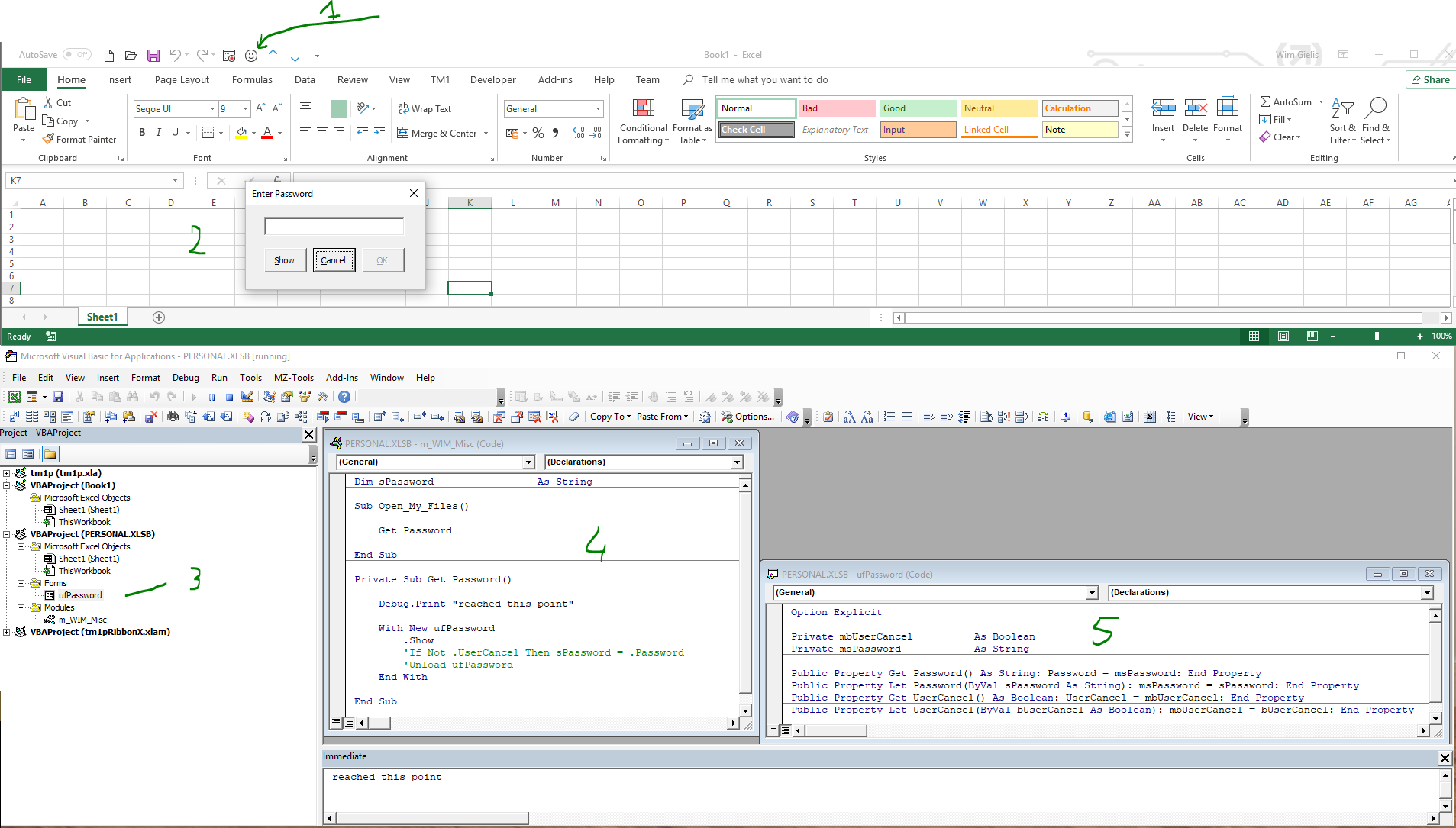

In my Personal.xlsb I have a macro to open files I use on a regular basis. This macro can be launched by clicking an icon in the QAT (Quick Access Toolbar). This (small) macro uses a second procedure, where a password is asked from the user ( me :-) ). The password is entered in a userform with a textbox since I want to hide the password - just in case someone is looking over my shoulder.
Now, opening Excel (therefore opening Personal.xlsb) works fine. Nothing happens initially, until I click the icon, I enter a password and a file is opened. But when I start Perspectives the macro in which the userform is shown also starts. Therefore, anytime I open Perspectives, I also get the question to enter a password to open a file I don't want to open.
How is it possible that opening Perspectives executes a macro in my Personal.xlsb ? It's not even a function but a procedure.
As soon as I have the code to .Show the userform, the macro is eligible for execution whenever Perspectives starts. No other VBA-code / addin is running at all.
I reduced all code to the below. Legend:
1: the icon to launch the macro in Personal.xlsb to open files I use often (macro: 'Open_My_Files' calling a second macro)
2: the userform pops up when I start Perspectives
3: the userform in VBA, nothing fancy
4: the code, reduced to the essential part, issue is still reproducible
5: the code for the userform. Other than a couple of variables, I have nothing there. I could even delete those given that in the Get_Password macro I commented out code as well.

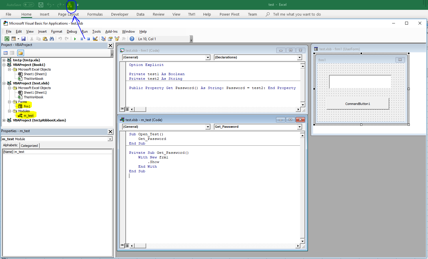

Update. It's not related to any particular userform. I reduced the issue to the following:
So, the icon in the QAT has the macro 'Open_My_Files' attached. That macro is just a Debug.Print of the current time.
Perspectives starts with Excel. This somehow executes the macro from the QAT icon, leaving the current time in the Immediate Window in VBA.

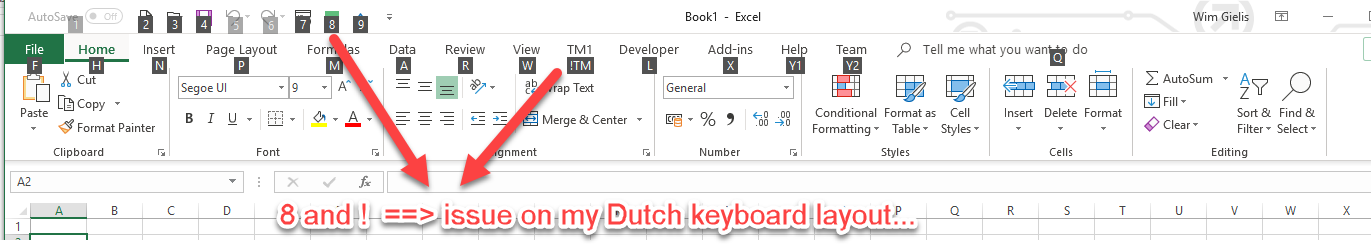

On my keyboard, Alt-8 is done on the numbers at the top of the keyboard, not the numeric portion of my keyboard. Here's a picture showing that it's the 8 entered as Shift-!
my keyboard
Wim

Perspectives tries to be helpful and selects the TM1 ribbon. The VBA-code creates the ribbon for TM1 with the name !TM
Therefore pressing Alt, then the ! key and Enter will activate that ribbon.
But if on my keyboard this is Alt-8 it executes a different macro, the one attached to the 8th QAT icon.
