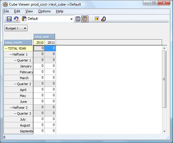

Post by appleglaze28 » Fri Nov 20, 2009 3:22 am
Hi Ajain
I tried the TI Process script you gave...I'm not sure where I went wrong since I'm sure where I went wrong somewhere cause the process was successful but the value still was not copied to the other element intersection of one of the dimension.
Prolog:
# ********************** Source Dimension Values **************************************#
# Type the member name if other than all
SrcDim1 = 'Budget 1';
SrcDim2 = 'All';
SrcDim3 = 'All';
SrcCube = 'test_cube';
# ********************** Target Dimension Values **************************************#
# Make sure only the target dimension that is being updated is filled
# Only required if it is changing
# THE VALUE CAN ONLY BE A LEVEL 0 Value.
TgtDim1 = 'Actual';
TgtDim2 = 'All';
TgtDim3 = 'All';
#TgtCube = 'test_cube';
# Declare View name
sView = 'Copy';
# Declare Dimensions
sDim1 = 'base_version';
sDim2 = 'base_year';
sDim3 = 'base_month';
# Declare Dimension Subsets Name
sSub1 = 'Copy - '| SrcDim1 |'';
sSub2 = 'Copy - '| SrcDim2 |'';
sSub3 = 'Copy - '| SrcDim3 |'';
# Declare Subsets Properties
# Only used if user choses something other than All in the parameters
sSubT1 = '['| sDim1 |'].['| SrcDim1 |']';
sSubT2 = '['| sDim2 |'].['| SrcDim2 |']';
sSubT3 = '['| sDim3 |'].['| SrcDim3 |']';
# Destroy previous view (if exists)
if (ViewExists(SrcCube, sView) = 1);
ViewDestroy(SrcCube, sView);
endif;
#Error Check
# Destroy existing subsets
if (SubsetExists(sDim1,sSub1) = 1);
SubsetDestroy(sDim1, sSub1);
endif;
if (SubsetExists(sDim2,sSub2) = 1);
SubsetDestroy(sDim2, sSub2);
endif;
if (SubsetExists(sDim3,sSub3) = 1);
SubsetDestroy(sDim3, sSub3);
endif;
# Create subsets
if (SrcDim1@='All');
SubsetCreatebyMDX(sSub1, '{TM1SORT( {TM1FILTERBYLEVEL( {TM1SUBSETALL( ['|sDim1|'] )}, 0)}, ASC)} ' );
else;
SubsetCreatebyMDX(sSub1, '{TM1DRILLDOWNMEMBER( {'|sSubT1|'},ALL,RECURSIVE )}');
endif;
if (SrcDim2@='All');
SubsetCreatebyMDX(sSub2, '{TM1SORT( {TM1FILTERBYLEVEL( {TM1SUBSETALL( ['|sDim2|'] )}, 0)}, ASC)} ' );
else;
SubsetCreatebyMDX(sSub2, '{TM1DRILLDOWNMEMBER( {'|sSubT2|'},ALL,RECURSIVE )}');
endif;
if (SrcDim3@='All');
SubsetCreatebyMDX(sSub3, '{TM1SORT( {TM1FILTERBYLEVEL( {TM1SUBSETALL( ['|sDim3|'] )}, 0)}, ASC)} ' );
else;
SubsetCreatebyMDX(sSub3, '{TM1DRILLDOWNMEMBER( {'|sSubT3|'},ALL,RECURSIVE )}');
endif;
# Create View
ViewCreate(SrcCube, sView);
# Assign new view as datasource
DatasourceCubeview=sView;
# Assign Subsets
ViewSubsetAssign(SrcCube, sView, sDim1, sSub1);
ViewSubsetAssign(SrcCube, sView, sDim2, sSub2);
ViewSubsetAssign(SrcCube, sView, sDim3, sSub3);
Data

I'm still tried testing Wim's also but neither gave me a successful outcome from testing it...I'm still in the process of learning TI more indepth
cube to test the process
ajain86
Posts: 132
Joined: Thu Oct 15, 2009 7:45 pm
Version: 9.4.1 9.5 9.5.1
Excel Version: 2003 2007
Re: Copying Data from 1 Element to Another via TI
Post by ajain86 » Mon Nov 23, 2009 2:36 pm
appleglaze,
can you please post the correct code for the Data tab? It looks like the same code as the prolog code.
In your view, you show that Budget 1 has all zeros. Budget 1 is your source?
