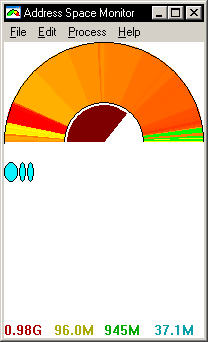

At the time of the failure the process (32bit) had just over a gigabyte allocated. What is probably happening is that of the available 2 Gb of address space there is not a single continuous block of the 44K required. This will be because each loop is allocating a block one byte larger than the largest one used so far and so TM1 is having to go to the operating system to give it another one. Furthermore TM1 is not giving back the previous blocks but is hanging on to them while the process is executing which means that the OS is allocating from an ever depleting pool. Using Address Space Monitor (http://hashpling.org/asm/) I got the following map of the address space just before it died.
So concatenation is not a goer, but in 9.5.2 not for the reasons stated in previous posts.
