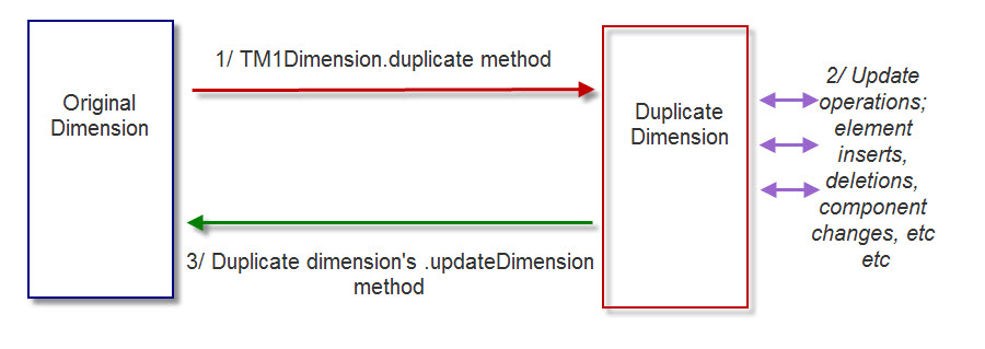

The Java API uses the "classic" way of updating dimensions, which is to duplicate the dimension, do the changes on the duplicate, and then update the original dimension:
I should mention for the sake of completeness that when Hubert Hijkers conducted his session on the new REST API immediately after mine, he mentioned that you can't do that in REST because it is, as the name suggests, stateless. Accordingly each command stands on its own and cannot refer to a temporary dimension. However that is something for the future; it is unlikely to be something that you'll see introduced into the Java API.
All of this is handled by the TM1StockWriter class.

Why both? Because as you will see we will need a reference to the currently registered dimension when it comes time to update it from the copy. We may as well get that reference here.
It then gets references (within a try block obviously) to each registered dimension, and creates a duplicate of it:
oTM1DimCountry = oTM1Server.getDimension("SP_Exchange");
oTM1DimCountryCopy = oTM1DimCountry.duplicate();
oTM1DimStockCode = oTM1Server.getDimension("SP_StockCode");
oTM1DimStockCodeCopy = oTM1DimStockCode.duplicate();
oTM1DimDateCode = oTM1Server.getDimension("SP_DateCode");
oTM1DimDateCodeCopy = oTM1DimDateCode.duplicate();
oTM1DimTimeCode = oTM1Server.getDimension("SP_TimeCode");
oTM1DimTimeCodeCopy = oTM1DimTimeCode.duplicate();

Checking And Updating The Dimensions
The last thing to do is a consistency check on each of the dimension copies. This is done using the same .check method that we used on the unregistered dimensions. If everything is OK, you call the .updateDimension method of the currently registered dimension, not of the copy. Rather, you pass a reference to the copy in to that method:
sMsgErr = "";
try {
	if(oTM1DimCountryCopy.check().getBoolean()){
		TM1Dimension oTM1DimNew = oTM1DimCountry.updateDimension(oTM1DimCountryCopy);
		if (oTM1DimNew.isError()){
			sMsgErr = sMsgErr + "Exchange dimension: " + oTM1DimNew.getErrorMessage();
	} // End consistency check.
} catch (Exception e) {
	sMsgErr = sMsgErr + "Exchange dimension: " + e.toString() + ". ";
} // End try for dimension update.
The Call To The addUploadTimeElement Method
After the loop to update the four dimensions whose elements come from the stocks Map, prepareDimensions calls the addUploadTimeElement private method. I'm not going to include a lot of code here because in terms of coding principles there's absolutely nothing that we haven't already seen already. The name of the element is a string which is derived from the current time:
// This will get us a Calendar object populated with the current date.
Calendar cal = Calendar.getInstance();
// Format that as a date string. This will be our new element.
gsSP_UploadTime = cal.get(Calendar.YEAR)
	+ String.format("%02d", (cal.get(Calendar.MONTH) + 1))
	+ String.format("%02d", (cal.get(Calendar.DAY_OF_MONTH)))
	+ "_" + String.format("%02d", (cal.get(Calendar.HOUR_OF_DAY)))
	+ String.format("%02d", (cal.get(Calendar.MINUTE)))
	+ String.format("%02d", (cal.get(Calendar.SECOND)));
We call the .getDimension method of the oTM1Server instance (which was passed as an argument, of course) to get a TM1Dimension variable which has a reference to the SP_UploadTime dimension, and we call the .duplicate method of that dimension.
We then:
  • Insert the new element using the duplicate dimension's .insertElement method;
  • Get a reference to the Total Uploads element by using the duplicate dimension's .getElement method;
  • Add the new element to the Total Uploads consolidation by using the consolidation element's .addComponent method, passing in the new element that we've created and a TM1Val object containing a double with the element's weighting (which in this case is zero rather than one);
  • Do a consistency check of the updated dimension duplicate; and finally...
  • Call the original dimension's .updateDimension method.
So, essentially the same sequence of events as applied to the other dimensions.

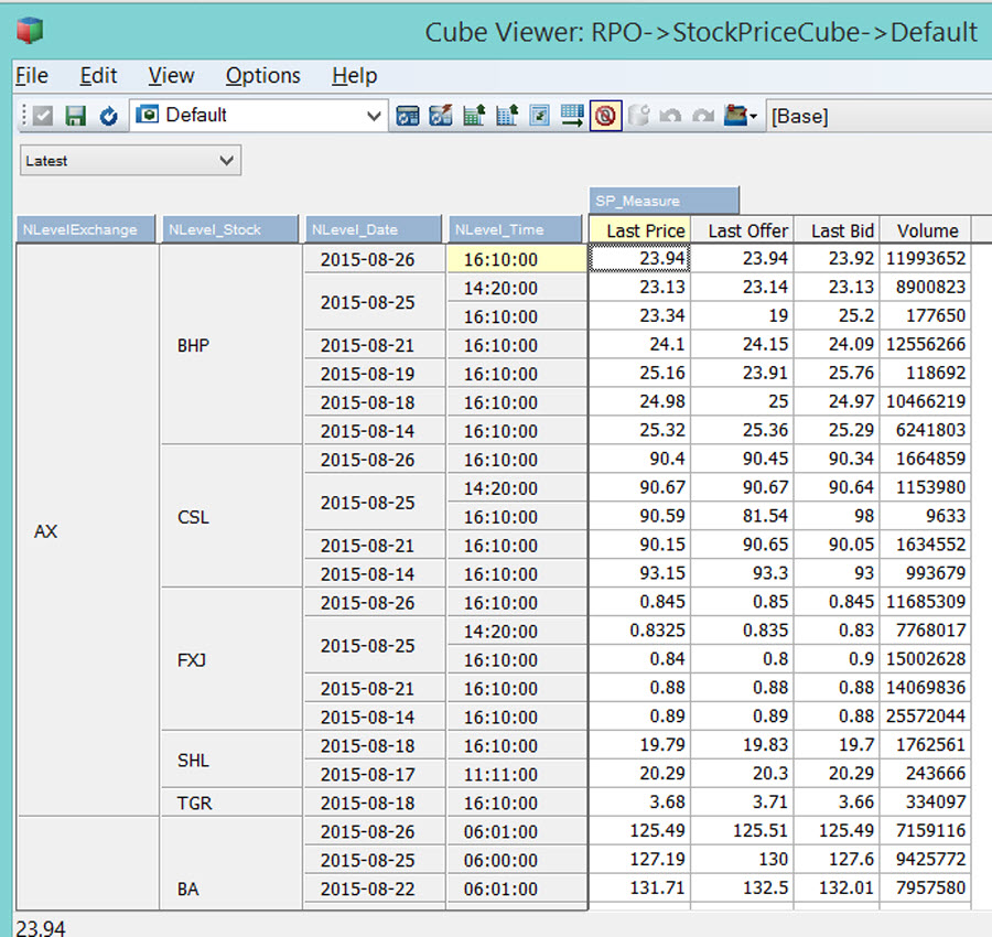

Let's first look at the cube as it was before doing anything:

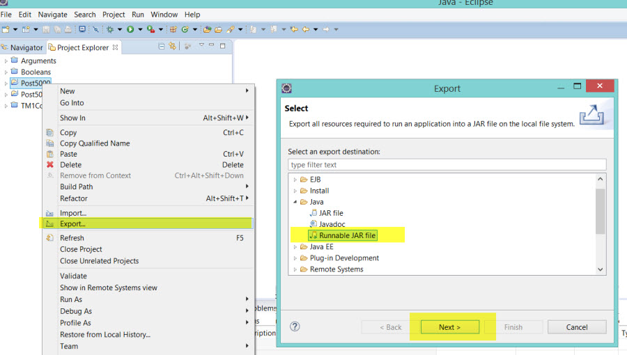

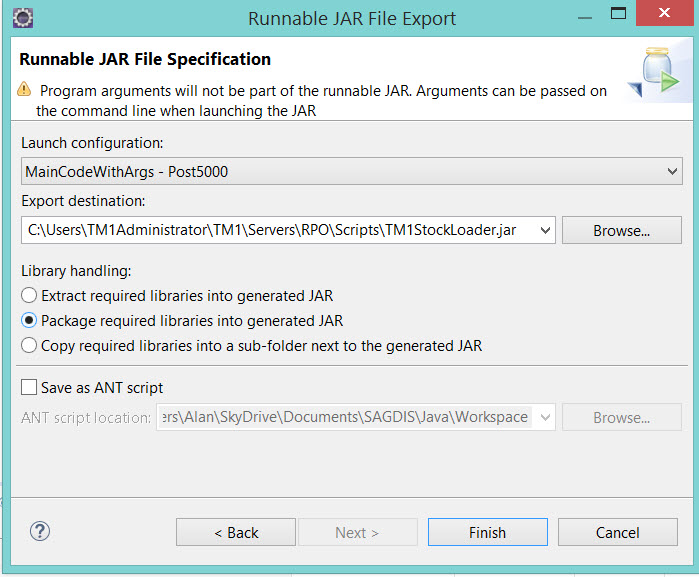

The last thing to do is to package the project into a form that can be run outside of Eclipse. I'm going to create it as a self-running .jar package, though there are other alternatives which are beyond the scope of this document.
In this case I'm going to write it out to a Scripts folder in the data directory of the server. I'm also going to elect to package the required libraries into the .jar file.

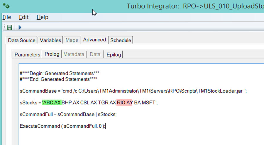

With that .jar in place, it's possible to run it from a TI ExecuteCommand statement that calls a command line via cmd /c. In this case I've hard coded the list of stocks, but they could just as easily be read from a cube. Note that one (ABC.AX) is a new stock code (in the sense that we haven't used it before; the company itself (Adelaide Brighton Ltd) dates back to 1882), and another (RIO.AY) is an invalid one. (RIO is Rio Tinto Ltd, but .AY is an invalid exchange code.)

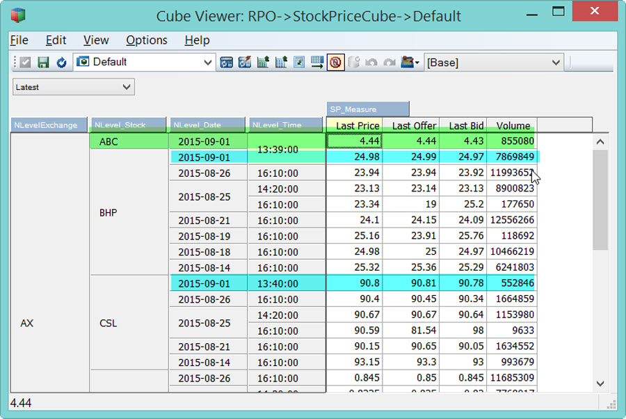

So let's run it and see what happens:
I took a couple of minutes out of my working day to run this while the ASX was still open. This was just on 14:00, so the new entries for 1 September have the expected time of 13:40ish. Note that the new code (ABC = Adelaide Brighton, in green) has been inserted. As this was the first run for that code, we have no prices for it for the dates that the earlier runs (seen in BHP, for example) had been done. (The Yahoo Finance API can provide historical values (but not by minute as far as I know), but I'm not querying those.)
And the invalid RIO.AY code? As we'd expect, in the error log we have:
That's it, we now have a working application.

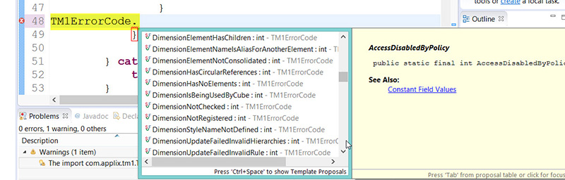

As previously mentioned, [Ctrl] + [Space] is probably the most important shortcut in the application. It loads the list of available objects, properties, methods, code templates, etc, depending on context. For a class, it will also either create the Import statement, or offer you a selection of matching classes to choose from.
