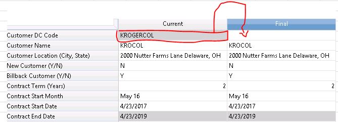

i don't think so,because our TI is able to copy data from current version to final version for some of the cells .please see the attachment.Highlighted cell is not transferring data.
Rajesh Dayaneni
Thank you for your reply.

Re: Rules Created by Links are not allowing us to copy data from source version to target version
I will ask again, because it seems very important here:
Is cTempViewTo your source view?
The name suggests that this is your target (ZeroOut) view, not the source. That would explain why the ViewExtractSkip functions are not having the expected result.
