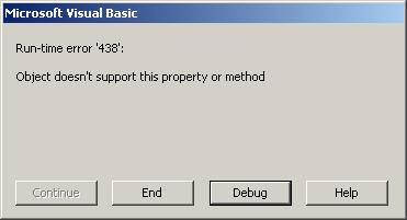

If I'm getting my value in a textbox, do I need to put double-quotation for it? Since I will be using the Textbox name, right?
Can anyone post a sample VBA script for creating a login prompt in Excel. I'm still studying VBA so I really need some help on this one. I'm not having any luck googling it up.
Private Sub CancelButton_Click()
' CLEAR BOTH TEXT BOX[attachment=0]Run-time Error438.JPG[/attachment]
TextName.Text = ""
TextPassword.Text = ""
End Sub
Private Sub LoginButton_Click()
' ERROR MESSAGE TO APPEAR WHEN CLICKING LOGIN BUTTON WITH NO NAME
If TextName.Text = "" Then
MsgBox "Enter your Username/ UserID."
Exit Sub
End If
' ERROR MESSAGE TO APPEAR WHEN CLICKING LOGIN BUTTON WITH NO PASSWORD
If TextPassword.Text = "" Then
MsgBox "You must enter your Password"
Exit Sub
End If
' RUN TM1 FUNCTION FOR LOGIN
Application.Workbooks("Sales Cube By Current Product.xls"). _
Worksheets("MainMenu") = Run("N_CONNECT", "Nexus", "TextName", "TextPassword")
End Sub

I still get the error if I copy what you wrote. I get a COMPILE ERROR: EXPECT: =
So I'm not totally sure how to make it work.
Re: VBA Macro for N Connect
You have to assign the result of the macro to e.g. a cell in Excel.

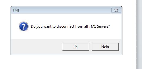

my problem is not the connecting or disconnecting. The command:
Testvalue = Application.Run("N_CONNECT", Serverbox.Text, Userbox.Text, Passwordbox.Text)
works.
My VBA-tool is semiautonomius, so the user connects with TM1 only, when he has to read or write data. Between those two situations the user has not to be connected.
The user can create sheets from the tool which athers can fill with values. This can be many sheets. After being filled this sheets are then written in my tool. When I do this, I have to quit TM1 as Excel tries then to recalculate every sheet.
I do this with the command:
When the sheets are then in the Tool and I will send them to TM1 I have to connect again. For this I have to start the TM1 addin again:
'TM1_File according to the windows version
by activating the workbooks.open there is a messagebox asking if I will quit all TM1-Servers, see attached file
After pushing the button twice, the makro works.
Question: How can I prevent the question about disconnecting?
Best Regards
Matt
works.
On Error Resume Next
Application.Run ("N_DISCONNECT")
Workbooks("tm1pRibbonX.xlam").Close savechanges:=False
Workbooks("tm1p.xla").Close savechanges:=False
Application.ExecuteExcel4Macro "UNREGISTER(""" & "tm1.xll" & """)"
On Error GoTo 0
Workbooks.Open(Filename:=TM1_File).RunAutoMacros Which:=xlAutoOpenCode: Select all
Version = Application.OperatingSystem
If Version = "Windows (32-bit) NT 6.00" Then
TM1_File = "C:\Program Files\IBM\Cognos\TM1\bin\tm1p.xla"
Else
TM1_File = "C:\Program Files (x86)\IBM\cognos\tm1\bin\tm1p.xla"
End IfAfter pushing the button twice, the makro works.
does not work...Application.DisplayAlerts = False
