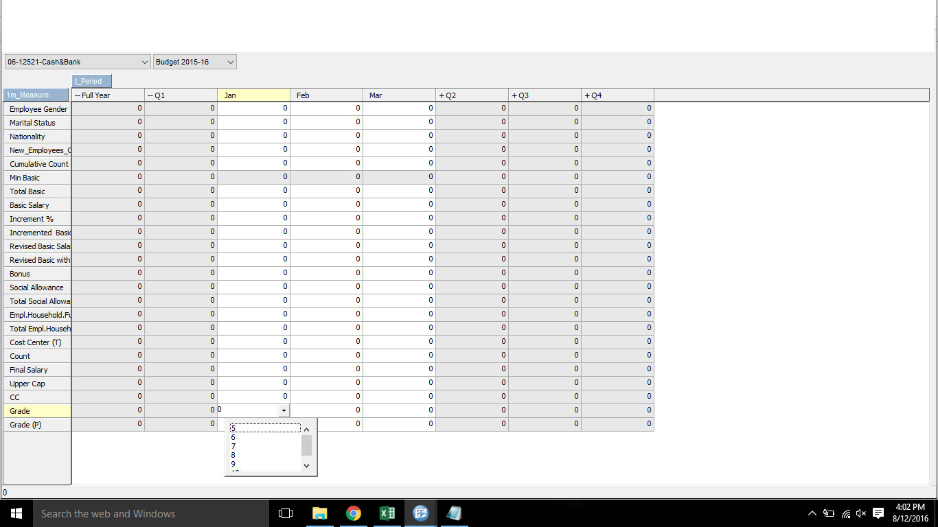

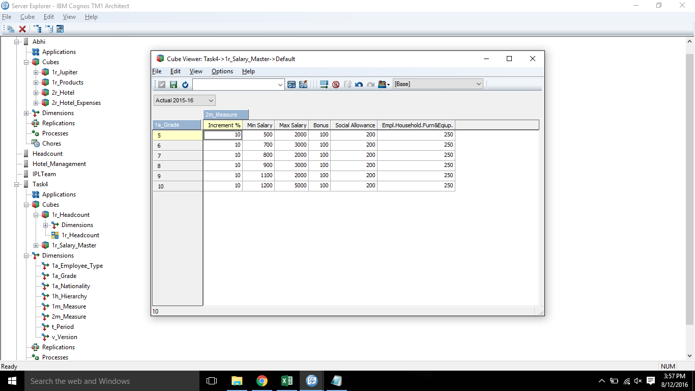

- Posts: 11
- Joined: Mon Aug 08, 2016 1:45 pm
- OLAP Product: Ibm Cognos
- Location: Mumbai
Re: Nested DB();
here i am attaching my 2 cubes..
if u can see their is a grade element in Headcount cube
i just want to do if i select grade 6 in that element
then the value should be fetched from 2nd cube which is salary master
- 2.png (43.98 KiB) Viewed 7247 times
- 1.png (75.39 KiB) Viewed 7250 times

You don't need the second nested DB(). Something like below should work, provided you store Grade in 1r_Salary_Master as a number. If you store it as a string then you don't need the STR() treatment.
You will also need to supplement it with a feeder, but in this case I would not do an intercube feeder and just feed within 1r_Salary_Master from 'Grade' to 'Min Basic'.
Edit: You will also need a v_Version reference in the rule somewhere, like in Wim's code, but it's impossible to know from your screenshots what the order of dimensions in your cube is.
['Min Basic'] = N: DB('1r_Salary_Master', STR(DB('1r_Headcount', 'Grade', !t_Period, !v_Version, !1h_Hierarchy),2,0), 'Min Salary');
