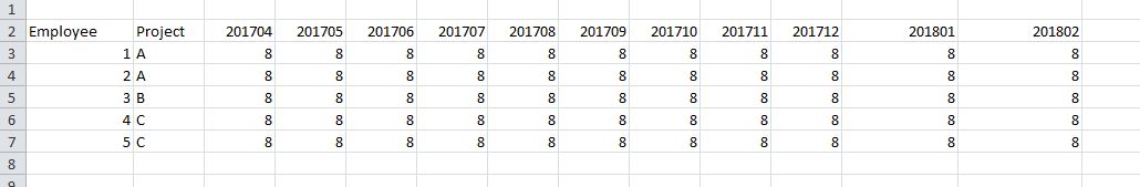

Hi Experts,
i am having data in following format.
the columns in yyyymm format is measure i.e. employee working hours. these columns are dynamic means data is available for 8,9,12 up-to 24 month.

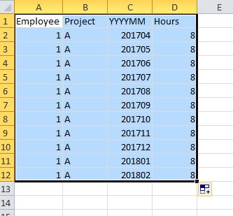

my cube have following dimension Employee,Project,Month,Measure dimension(hours) because of uncertainty of month columns i need to convert this file in below format and then load.
is there any way that i can directly use the original file to load the data? one way is to involve ETL team to load these files in database and then load it to TM1 but i want to achieve this in TM1 any .vbs or .bat utility can also work who can transpose the file in desire format.
