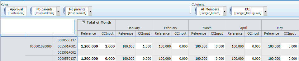

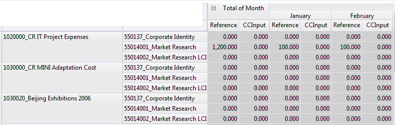

Hi, Expert,
please let me make my question more understood, please see the below picture.
what I really want the row format should be:
1020000,55014001;
1030000,55014002;
1030020,550137;
Thanks!

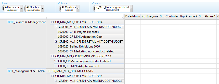

2.I wrote the cellsecutiry rule like this, which leads to the below result, but I don't want the 'blank' rows shown, I prefer to hide them. is there any way to do this?
[]=S:IF(DB('}tp_intermediate_RDCLS}BU1',!Costcenter,!}Groups,'all_applications','StaticRights')@<>'' &
(!Costcenter@=ATTRS('InternalOrder',!InternalOrder,'Column 5') &
!CostElement@=ATTRS('InternalOrder',!InternalOrder,'CostElement')),
'WRITE',
CONTINUE);

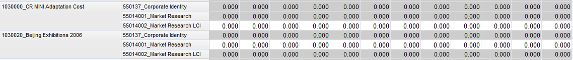

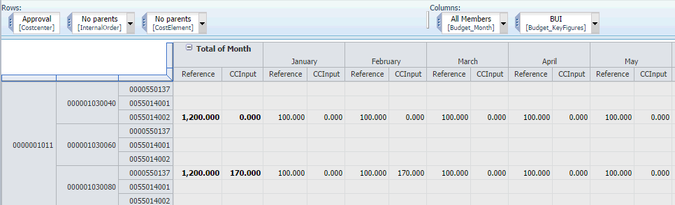

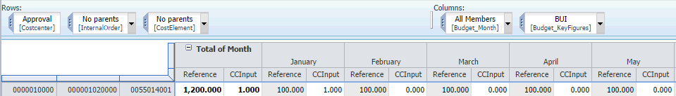

3.Regarding the zero suppress,suppose that when users open an application, and before input budget, they surely don't want to see redundant rows. After pressing 'zero suppress' button, all the rows with zero cells disappears, including the rows with all editable cells are zero, which is not what I want. because before editing, the values of these cells are surely zero...
before pressing 'zero suppress' button.
after pressing 'zero suppress' button.
