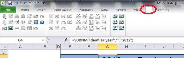

1. TM1 add in tab missing.
when user open report in perspective, the report opened but the add in is disappeared.
Attached attachment1.

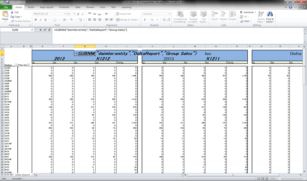

2. double click on the subnm, the filter not show.
the user double click on the cell that contain subnm, the dialog box do not show. just become text edit.
attached attachment2.
please shed some light on it.

The symptoms you are seeing is indicating the the Perspectives add-in has not actually been loaded. Go back and make sure the add-in is loading when Excel is opened and that should fix your problem.
Re: Perspective issues
tomok wrote:The symptoms you are seeing is indicating the the Perspectives add-in has not actually been loaded. Go back and make sure the add-in is loading when Excel is opened and that should fix your problem.
Not in this case, I think. Had the add-in not been loaded there would have been nothing to create the tab and icons. The disappearance of the text is a known issue and there's a technote on it somewhere. (I know it's referred to in one of my TM1 Bytes videos but I'm only on my mobile at the moment and will have to look it up later.) As best I recall updating all service packs in Excel should fix it.
The second issue appears to be an Excel option. Make sure that the Edit In Cell option is UNchecked.

Alan Kirk wrote: The disappearance of the text is a known issue and there's a technote on it somewhere. (I know it's referred to in one of my TM1 Bytes videos but I'm only on my mobile at the moment and will have to look it up later.)
It's in Byte 040 at around the 07:30 mark. The technote referred to was 1413700. However:
(a) That referred to Excel 2007, whereas Charles is using 2010;
(b) The technote has been updated since I made that video. At the time the latest SP for Excel 2007 was SP2. There was apparently a subsequent one (SP3) which broke the fix again;
(c) Although the Abstract of the problem refers to actual Excel crashes, it also applied to the slow redrawing that can cause the ribbon not to be fully redrawn as per Charles' first image.
Double however:
(a) Although I said in the film that I hadn't seen the problem after updating to Excel 2007 SP2 and 9.5.2... I did after that on occasion. It's intermittent, and I haven't found a way of consistently reproducing the thing, but yes, it can happen.
I would still recommend that you make sure that you have all SPs / FPs implemented on both Excel and TM1. If it persists (particularly if you're on Citrix) you may need to disable the ribbon as described in the article.

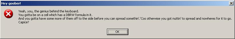

A GUI design approach that is somewhat less fixated on brightly coloured, dynamically changing eye candy might instead leave all of the icons enabled and simply change the context of what they do. Specifically, if the user tries (for example) clicking a spreading icon when they're in an empty cell, then instead of trying to do the spreading and erroring out it could pop a dialog box up in front of the user:
In this way you make the application self-educating, and you don't screw up Excel by drawing and redrawing and redrawing the ribbon tab every sodding time the user moves from this cell to that cell to the next cell. Who thought that was a good idea anyway? Just because a feature (like Excel's ability to disable ribbon items)is there, it doesn't mean that you use it. It certainly doesn't mean that you need to bash it with a hammer by using it with every cell movement. I mean seriously; they wrote it themselves: "This is not a normal case for standalone Excel 2007 where ribbon buttons usually do not change status often." Yuh-huh... why do you think that is, hello??

Alan Kirk wrote:The second issue appears to be an Excel option. Make sure that the Edit In Cell option is UNchecked.
Now that I have Excel in front of me... in 2010 it's File tab => Options (in the left hand column) => Advanced tab => Allow editing directly in cells. It's checked by default but if you don't turn it off you'll get the kind of thing that you show in your second image when you double click a SubNm formula.
