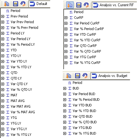

Lookup Measure
Lookup Measure

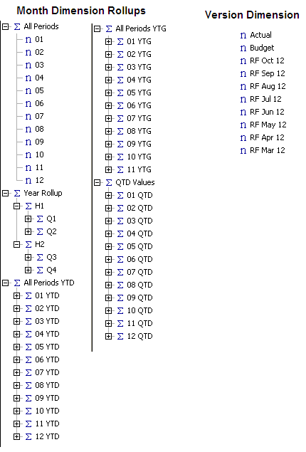

The dimension has only one element where data is loaded to, called "input value", "period value" or in this case just "period". All other elements are calculated. The dimension is structured such that all other elements are parents of the input value as this avoids any requirement to feed the calculations.
Note there is element security on the dimension such that users see all elements EXCEPT "user invisible". This avoids users being able to drill down on the parent. (You can also give a format for the element of "b:;;" to suppress display of any numbers as well.)
Of course there are still month and version dimensions in the cube.
With the lookup measure dimension and rules in place you can even choose to use element security to hide the month rollups from end users to make the interface more streamlined. (I tend not to as this can be dealt with via training and the month dimension tends to be used in other places as well where direct access to YTD and YTG rollups is useful for users.)
How the time offset works is that basically if "Period Value" is selected in the Lookup Measure dimension then there are no lookup rules applied, everything is "as is" with reference to the currently selected element in both the Month and Version dimension (that is this is equivalent to a "standard cube" without the extra lookup measure dimension). However as soon as a lookup measure calculation element is selected then the value displayed references and offsets based on the selected month (or version). So it is all absolutely dynamic in the crosstab. works brilliantly in all native TM1 interfaces and EV, I can't see any reason why it wouldn't also work in the Cognos Studios (usual watchouts with element security which seems problematic with MDX hierarchy traverses). All the offset calculations take a bit of setting up but it is largely a once off exercise as they are fairly portable (provided you make good use of attributed in the time and version dimensions and have something like a "zDates" cube to leverage in the rules.)
As there's a limit of 3 attachments I'll post an example below.

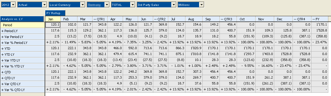

Here's one of possible very many examples of how it works in a cross-tab:
I initially thought to blur the numbers but it defeated the purpose of the example as an illustration of the technique so the figures are scrambled from reality instead but still serve the purpose of being able to follow the calculation and reporting logic. (If 2011 was selected for the year filter not 2012 then you would of course see all the "LY" values reflected in the "Period" and "current year" time offsets.)
Also a point I didn't emphasize in answering Lance's question but in case it isn't obvious it isn't a matter of having a special "Relative Last 12 months" time dimension or having 2 month dimensions in the cube or even having a separate "Relative cube". You use just one cube with the same year and month dimensions as always, it is just the inclusion of the additional "lookup measure" dimension that makes all the relative, offset and variance reporting happen.

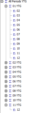

LanceTylor wrote:What rolls up to the YTG and how is it used? (This is the first time I have heard of this)
"YTG" Is short for "Year to Go", it is the inverse of "Year to Date" and essential to any planning model and any situation with split Year and month dimensions where moving annual total (MAT) calculations are required.
For MAT having YTG in addition to YTD makes the calculation simple:
[MAT] = DB('cube',...,DBRA('Year', !Year, 'Prev Year'), !Month | 'YTG', ...) + DB('cube',...,!Year, !Month | 'YTD', ...);
(clearly fill in your own case specific correct rule syntax).
(The number of times I've audited a model to find 12 separately handcrafted MAT rules one for each month, each with 12 separate additions I couldn't tell you but I've certainly lost count ... )
YTG is also immensely useful for planning applications to allow spreading over the remaining months of the year which are still forecast.
What to build in the rollups should be obvious but in case not.
You can nest YTD and YTG consolidations such that each only has 2 children. I am NOT a fan of this approach,1/ because it violates the principle of each dimension level within a given hierarchy having a consistent definition of what it is, but mainly 2/ because it creates clutter and is not as easy and non-intuitive for users to navigate.
(point 1 ("normalized" or "balanced" dimensions) is of course nonsense for "business oriented" dimensions like chart of account, division, legal entity, etc where ragged or unbalanced hierarchies simply make sense as the concept of "level" is meaningless, but for dimensions like time and often SKU or product it often makes a lot of sense.)
