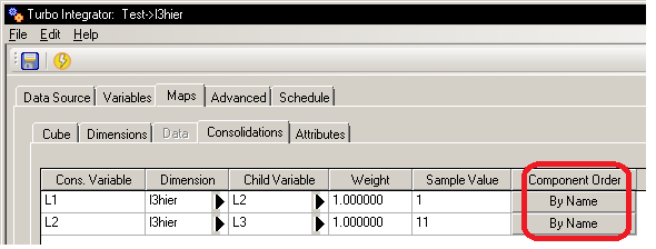

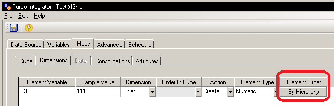

To get the sort order correct you need to use the appropriate buttons on the Dimensions and Consolidations tabs.
Dimensions tab
Dimensions tab
and
Consolidations tab
Consolidations tab

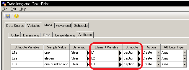

To get a single attribute for the three caption columns you need to use the same attribute name for each and specify to which level of element it applies, as in the following example.

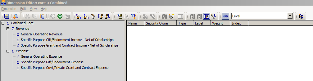

Changing the Element Order on the Maps/Dimensions tab to "By Hierarchy" and the Component Order on the Maps/Consolidations tab to "Automatic/Name/Ascending" does give me the results I wanted!
Correct Dimension Structure.PNG (3.35 KiB) Viewed 9616 times

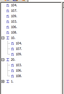

I was a bit surprised to see at least one iteration of my attempts created a dimension where the same element appeared in multiple places. I thought it could appear once and only once, at least in the basic Dimension.
Hosed Dimension Structure.PNG (4.41 KiB) Viewed 9616 times

FarmboyEsq wrote:I was a bit surprised to see at least one iteration of my attempts created a dimension where the same element appeared in multiple places. I thought it could appear once and only once, at least in the basic Dimension.
An element can exist in multiple hierarchies inside a single dimension. When they say an element can only exist once in a single dimension they mean you can't have two elements with the same name. For example, in a Year dimension you can only have the element "January" once. January can roll up to multiple parents, like 1st Quarter, or January - YTD, but you can only have one January.

On the attributes tab the "Element Variable" field lets you choose one of the columns from the variables tab. If that variable is used to provide the item name then the corresponding "Attribute Variable" will provide the value for the attribute specified.
Why not try it out and have a look in the generated code in the Data section of the Advanced tab. For the example from which I captured the screenshot I got the following :-
ATTRPUTS(L1a,'l3hier',L1,'caption');
ATTRPUTS(L2a,'l3hier',L2,'caption');
ATTRPUTS(L3a,'l3hier',L3,'caption');
You can see that it is using the correct L*a column for the "caption" attribute of the corresponding item L* as specified on the attributes tab.

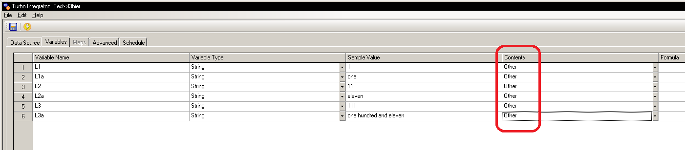

On the subject of using the wizard or not, I think Declan was saying there may come a time when what the wizard can produce is not enough for you. That's not the case here but when it does happen you can choose "Other" against all of the variables in the Variables tab and then just write your own code in the Advanced section.
Variables tab
Variables tab
Each of the variables in the variables section will be available in the Metadata and Data sections. The process runs the code in the Prolog section once. Then it runs the code for the Metadata section once for each row in the source. Then it runs the code in the Data section once for each row and finally it runs the code in the Epilog section once. Typically you would set stuff up in the Prolog, create dimension elements in the Metadata section, add data to cubes (including attributes) in the Data section and then clean up in the Epilog. Dimension elements that you insert in the Metadata section are not available to add data against until the Data section.
I found that the best way to get started writing my own TI was to use the wizard, then copy the code out of the generated sections and place it below. Then I would change the variables to "Other" (which clears out the generated sections) and then go back to modify the code to do what I wanted. After a while you will just go straight in and write the code.

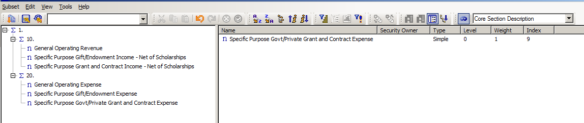

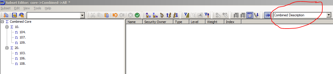

Here's the next thing I noticed though, relative to my alias attributes, which I think are loaded correctly. I seem to be unable to get the alias to display at all levels simulataneously in the Dimension viewer (Subset editor).
Combined Alias.PNG (28.2 KiB) Viewed 9569 times
Revenue Expense Alias.PNG (27.53 KiB) Viewed 9569 times
Core Section Alias.PNG (29.96 KiB) Viewed 9569 times
I'm sure I'm missing something here, because the notion of using alias to support an alternate language, would (i think) mean the entire dimension would appear in that alternate language. Is this the type of question that I should start a separate thread for?

You've set up an alias per level in the hierarchy in the dimension. And as you noticed, you can display only one alias at the time.
What you need to do is create one alias (f.i. 'Description') and load the attribute values for each level on this single alias. After this you can select the alias and you will see the required descriptions on every level.

Thank you -- this worked!
It struck me as I left work yesterday, that the "Attribute" property (concept? category?) of the Maps/Attributes tab has the potential to transcend multiple elements (levels) in the dimension.
I was thinking of it being only relevant to a specific level and not to the larger dimension. I've connected the three elements to a "Level" attribute, and am now seeing what'd I'd hoped to see.
